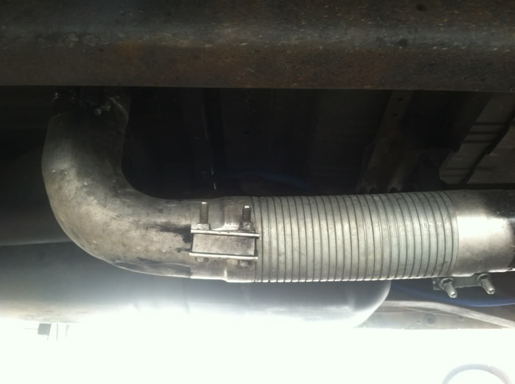

I can get a pic but its down pipe to a straight 4inch pipe back to almost the end of the cab to a 4inch flex pipe to a 90* 4inch pipe to my t-pipe. all hels together with 4inch to 4inch clamps.... very simple.

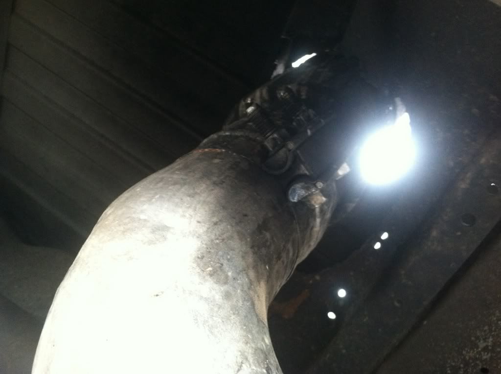

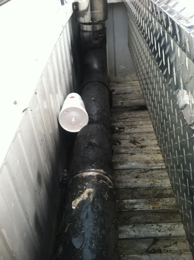

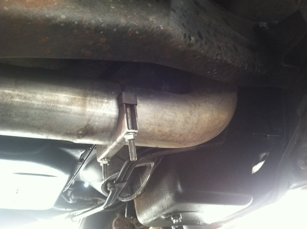

Postby Tsbourne09 » Wed Feb 22, 2012 5:19 am
bad pics but its the jist of it. simple and cheap done from home...
ignore all the black melted plastic on my t pipe and the half melted mc donalds cup. lol. i have a new t pipe to go on it then i remove everything for paint.

Postby Diesel Dawg » Thu Feb 23, 2012 1:53 am
WHAT THE HECK DID YOU MELT WITH THAT THING!!!!! I always wanted stacks but now I dont know! :shock: :shock: :shock:

Postby Tsbourne09 » Thu Feb 23, 2012 6:19 am
This t pipe was on the 6.7 so it got realy freakin hot. They dont get hot enough on my 1st gen to really melt plastic...
