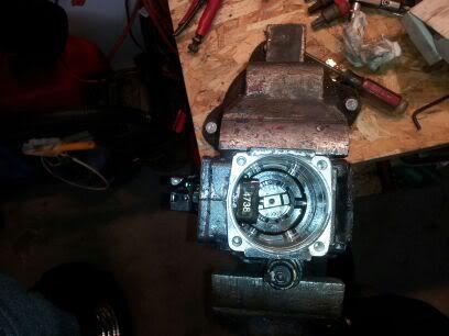

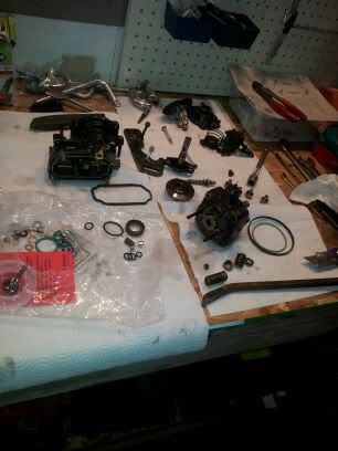

This I can say was no little leak. I did have a previous small leak coming out of the front of the pump at the governor shaft though these others stemmed this past weekend were not subtle or small by any means. I could hear the fuel hitting the ground. Anyway I did purchase the re-seal kit through central motive power here in CO and attempted to get the job done but ran into a couple of other snags.

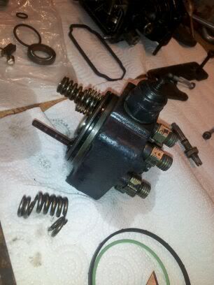

What I found inside. Any ideas as to what have caused this??? Broke the spring in two seperate places.

Could my broken spring in the above picture or all of the waterfall like leaks be some kind of pre-emptive symptom of a bad pump or what do you guys thing I'm looking at ?
