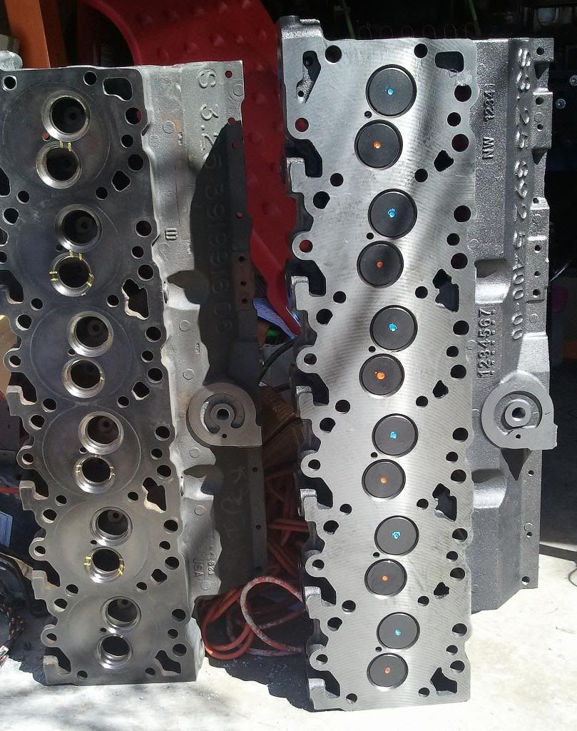

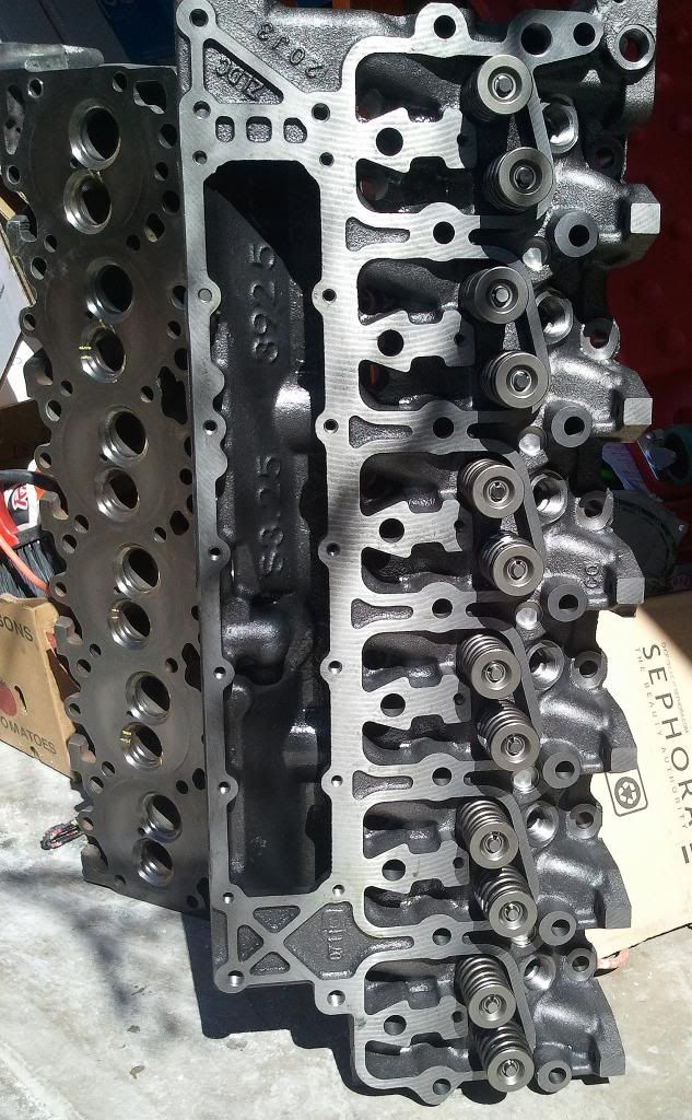

Postby mhuppertz » Thu Feb 28, 2013 1:14 pm
I hope it isn't a Chinese piece of junk...
mhuppertz
Re: New Head Arrived
Postby Mark Nixon » Thu Feb 28, 2013 3:51 pm
I wouldn't worry about Chinese quality, a lot of Cummins parts are made in many different places.
Let's face it, everyone wants parts for a cheap price, sometimes in doing that quality may suffer.
BTW, I have seen and heard of MORE USA heads being cracked than any other.
Also, since there are obviously CUMMINS numbers cast into it, it likely IS a Cummins-Authorized part.
Postby mhuppertz » Thu Feb 28, 2013 3:56 pm
Mark Nixon wrote:I wouldn't worry about Chinese quality, a lot of Cummins parts are made in many different places.
Thanks man. You made me feel much better about it!

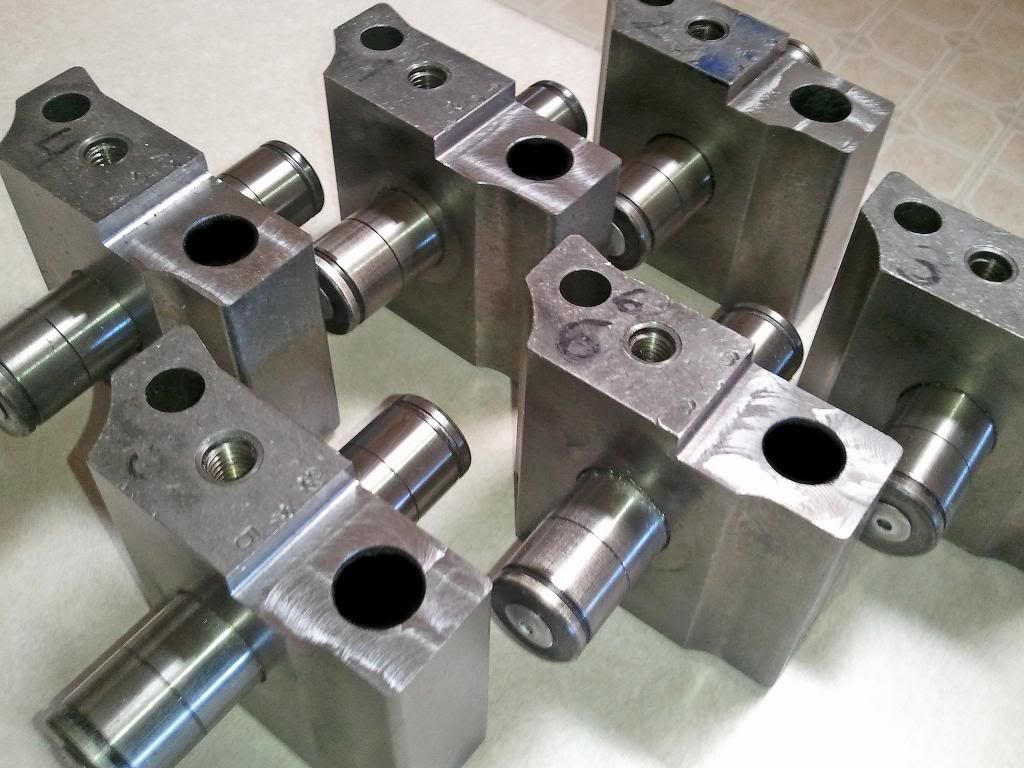

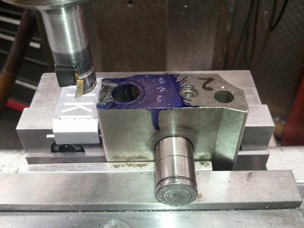

Postby mhuppertz » Thu Feb 28, 2013 4:01 pm
I machined the rocker stands this afternoon!
mhuppertz
Postby PToombs » Thu Feb 28, 2013 5:25 pm
Nice job! They used a surface grinder on mine, whatever that is. :lol: It only cost $40 so I thought that was ok.
Drill out the fuel filter holes while it's sitting there. :mrgreen:

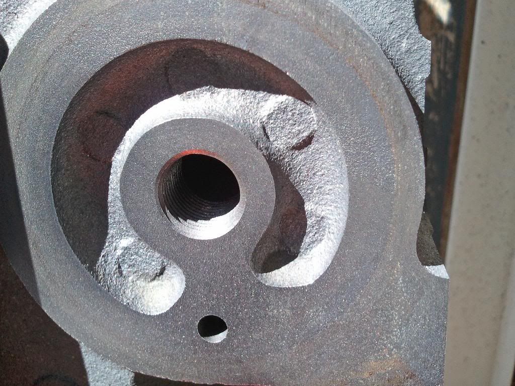

Postby PToombs » Thu Feb 28, 2013 5:56 pm
Nope, no sticky. I was just looking at the bottom of the new head and saw that the 1 hole is really small. I had thought of it before about drilling that hole a little larger to get more fuel thru it. We go to all the work of drilling banjo fittings, why not the head too? Now is the time, it's accessable and you can clean it out easy afterwards. Just don't drill into the gasket area..... ;)
I thought of doing mine, but I think it's getting a remote filter to handle a lot more flow.
Postby mhuppertz » Thu Feb 28, 2013 6:04 pm
Thanks, I will look at that.

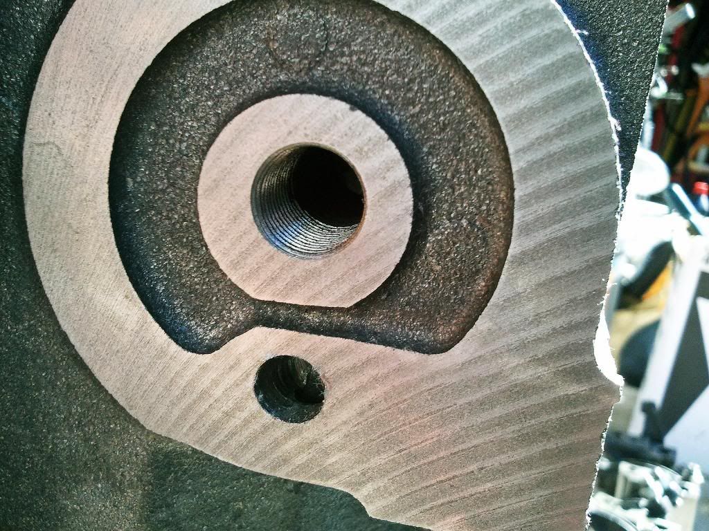

Postby mhuppertz » Sat Mar 02, 2013 7:16 pm
Took your advice Pete!
Worked up to a 1/2" bit and made sure the hole didn't intersect the gasket contact area.
Will be interesting to see if my top end fueling improves!

Postby PToombs » Sun Mar 03, 2013 2:43 pm
Wow! That looks huge! 8) Let us know if it makes a difference.
