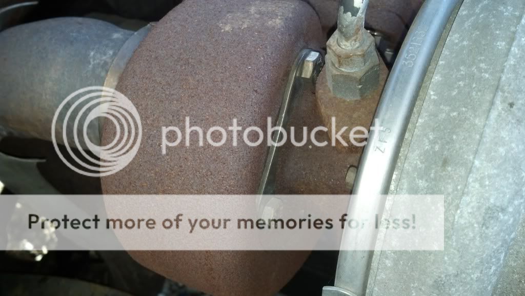

Thanks all. I heated them a bit and lightly taped them and eventually they came out but now I'm starting to tear it apart and I I've come into another problem. Two of the four bolts holding the exhaust housing on dont have enough room to thread all the way out. They are the two behind the oil inlet and the outlet. I would post pics but am not by a computer at the moment. Not sure if I can loosen them then move the housing off a bit to give them more room then thread them out completely. Will post pics wen I can if that helps. Thanks

Sorry. Guess I worded that wrong. i got the turbo off and one of my studs did come off but I was able to thread it out all the way.
I'm trying to take the turbo itself apart to rebuild it and two of the bolts holding the exhaust housing are hitting the center section where the oil inlet and outlet are. Like I said don't know if I can thread them out a bit then move the housing off a little to give them more room but I don't want to start trying stuff and possibly mess something up.

Are you talking about these bolts?
There is one on top and bottom? Might be able to twist the exhaust housing enough for them to come out if its not froze on there really bad.

yep thats them. u beat me to it was about to post pics. ok ill see if i cant twist it a bit to give them some room. I was scared to try and move it any cause i wasnt sure how it sits on there and didnt want to mess anything up. Thanks

No alignment pins in those. Those plates just act like a clamp. Rust will be the only thing to keep the housing from rotating. May need to soak and heat that, too.

If this were an HX35, you could use bolts to pre-load the housing by pushing on the compressor's back plate, then heat the housing with a torch until it pops loose.
But that won't work on the H1C with the bolted aluminum back plate.
