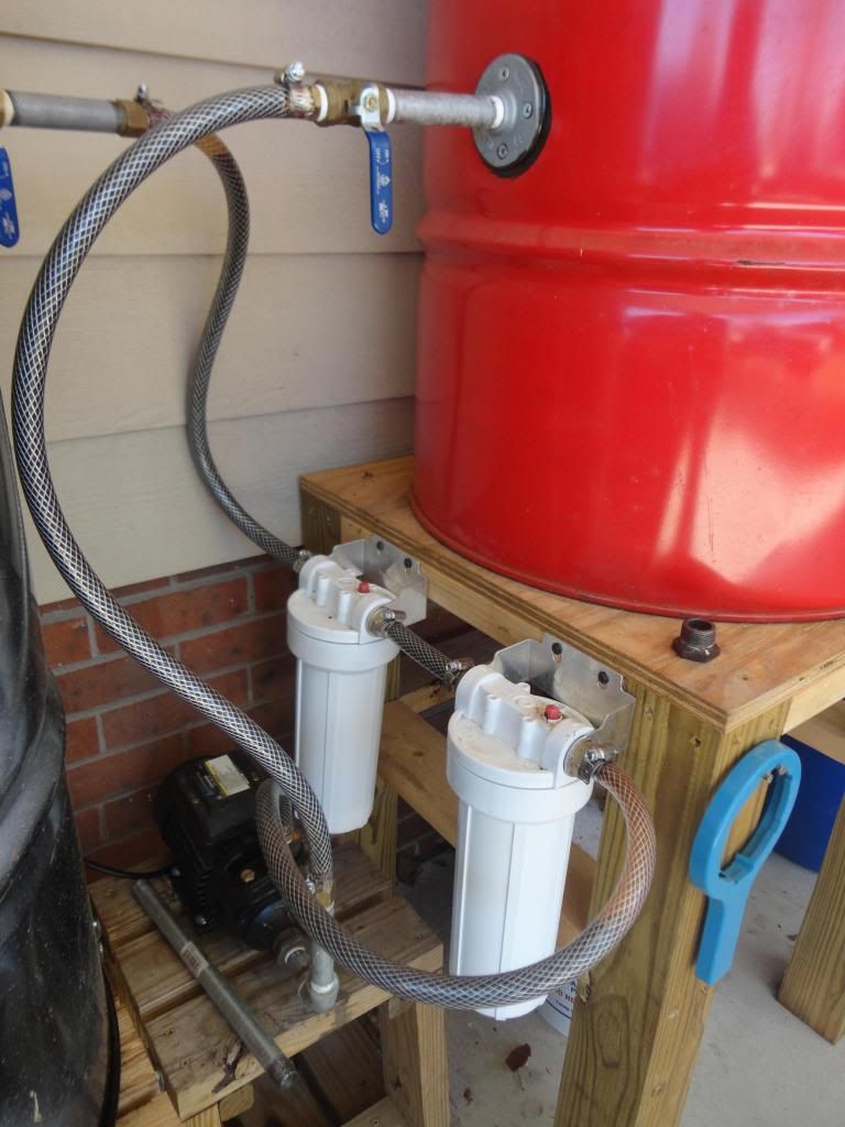

I ran it in my 12v second gen for a couple thousand miles. Settled in a 55 gallon drum mixed with 13% RUG for a week or two, drained the moisture and crud from the bottom using a ball valve I installed, used a $30 Harbor Freight 60gph clean water pump to push it through a 5 micron whole house filter then a 2 micron whole house filter and into a second drum. From there it went into the tank.

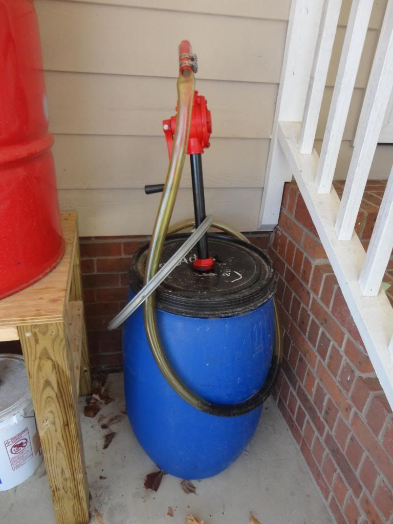

Postby the.beard » Thu Dec 26, 2013 4:22 pm
Sure. I collect oil from a shop down the road that gives it to me for free using a hand-pump and a couple feed barrels:

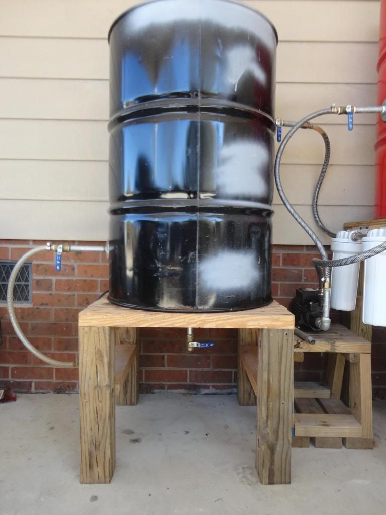

Then I move it into the settling tank and add 13% unleaded gasoline (or about 5.5-6 gallons per 50 gallons of oil). I let that sit for a week to let the water and general filth settle to the bottom, which I then drain off using the ball valve at the bottom.
Then I plug in the pump and let it work, pushing the oil through two whole house filters from Lowes.

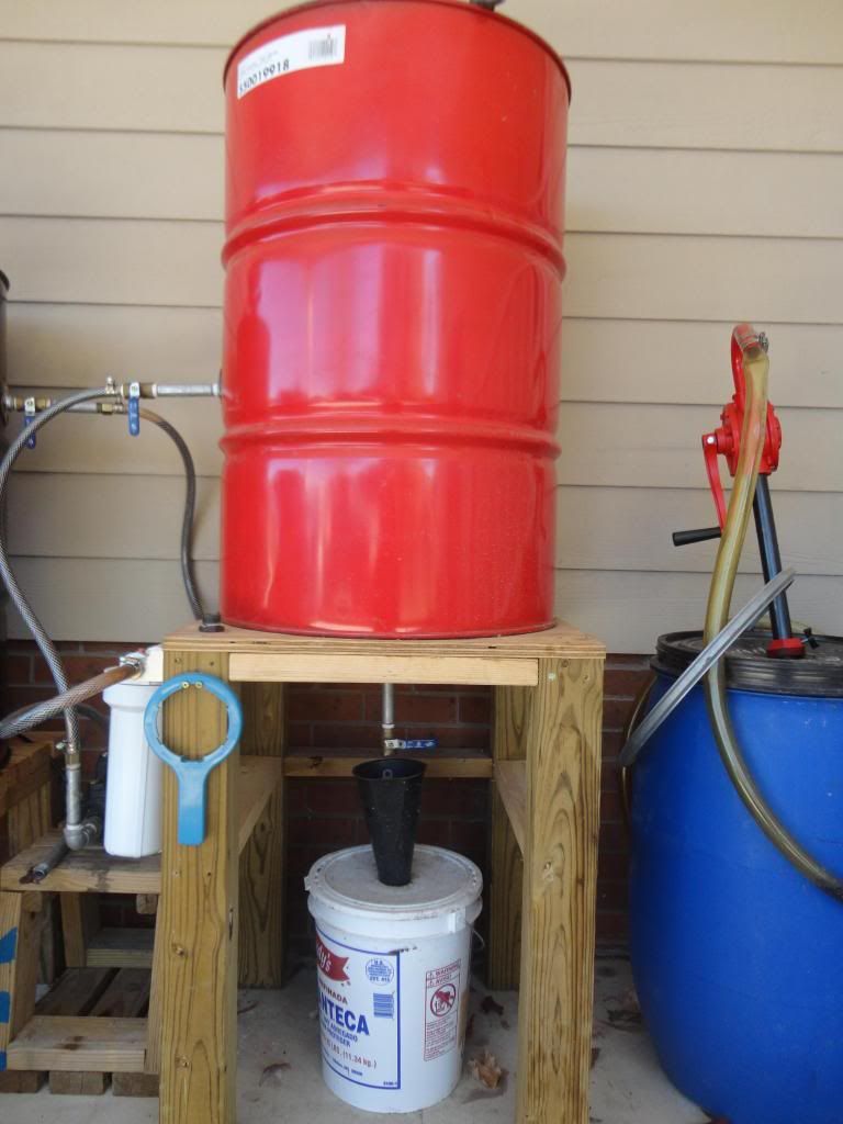

Finally, it goes into the last barrel where it's ready to go into the truck.
