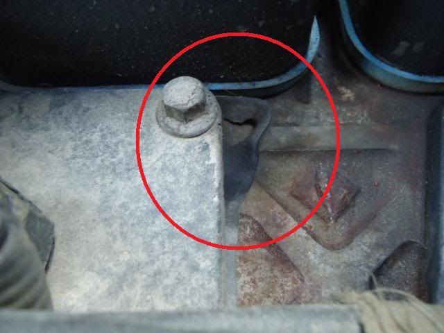

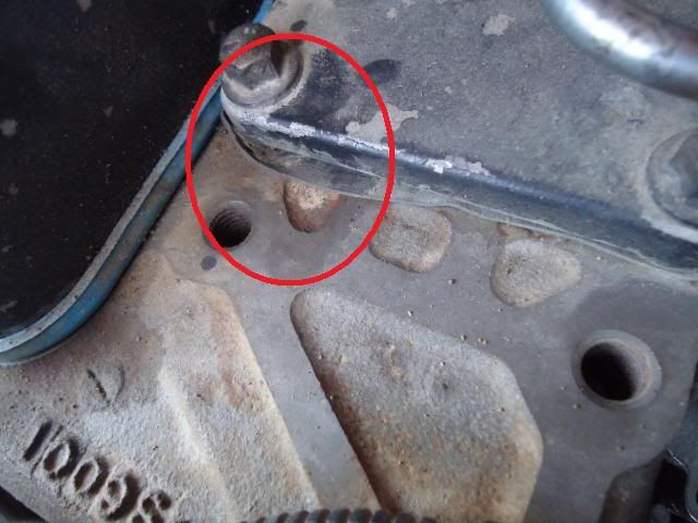

Postby 90cumminscoal » Mon Nov 25, 2013 8:22 pm
Ok I'll check the manifold bolts and my intake bolts were loose I'll replace the gaskets just to be sure. I'll fill yall in over weekend when I get back in.

Postby dazedandconfused » Tue Nov 26, 2013 2:04 am
Have you pressureized the system with shop air to try and track it down. I wouldn't be surprised if its not the intercooler.
Re: Turbo noise under boost HE351CW
Postby RCCUMMINS89 » Tue Nov 26, 2013 1:45 pm
When I blew the intake gasket on my truck......it was louder than a train whistle, but still made full boost.
