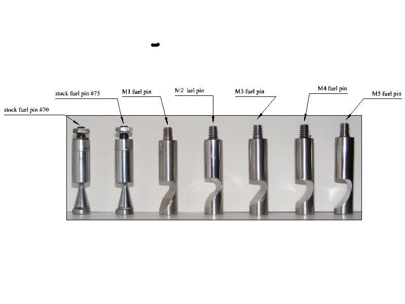

Postby Richie O » Fri Jan 23, 2009 11:14 am
Alwaysworking on DTR.
I found a picture last night.
