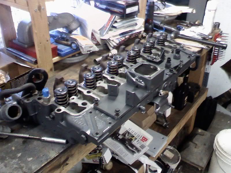

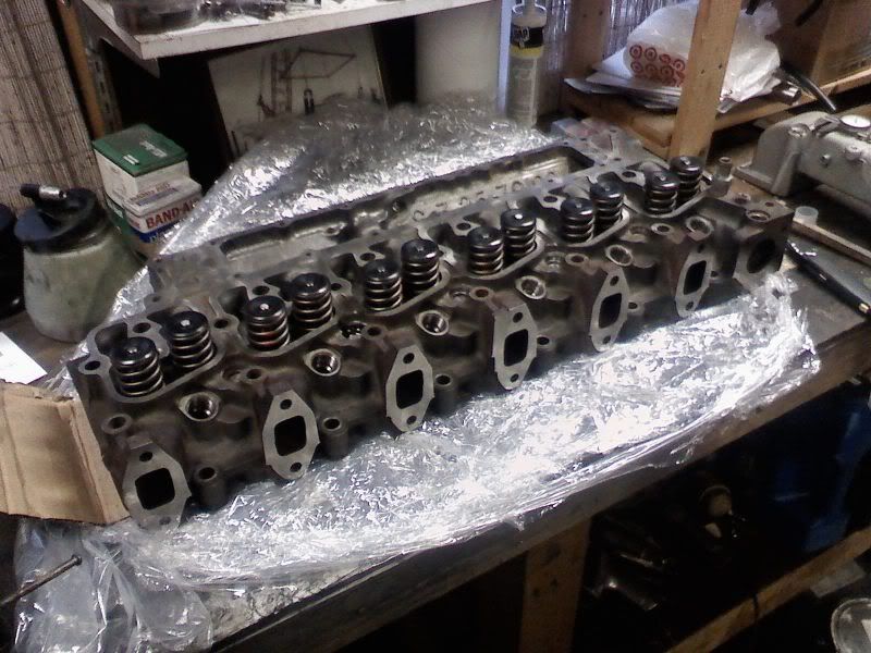

Getting ready to install the head next week or so. Had special springs installed and an O-ring job done.. Cant wait. This is the best picture I can post..No close up photos..
Reference picture...stock valve springs

Postby gear jammer 91" » Fri Apr 24, 2009 7:29 pm
Nice! I'm hopping to get a hold of used head to have the same stuff done to soon. Let us what kinda power gains you see.

Postby mprmn08 » Sat Apr 25, 2009 3:45 pm
just out of curiousity are you plannin on a big cam or something cause those look to be some pretty heavy springs?

Postby randyswelding » Sat Apr 25, 2009 6:45 pm
ditto on what cam and did it get ported and polished?

Postby SNOOT » Sat Apr 25, 2009 10:00 pm
Yes a cam also have a photo of it next couple days..

Postby dpuckett » Mon Apr 27, 2009 10:43 am
The heavy valve springs could also be for higher RPM running- stockers are only dependable to about 3300rpm or so. Not saying I havent turned more, but I wouldnt recommend it on a daily basis.

Postby SNOOT » Mon Apr 27, 2009 2:15 pm
I don't run a tach but the pump is set to govern at 3.5K right now.

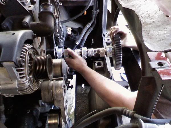

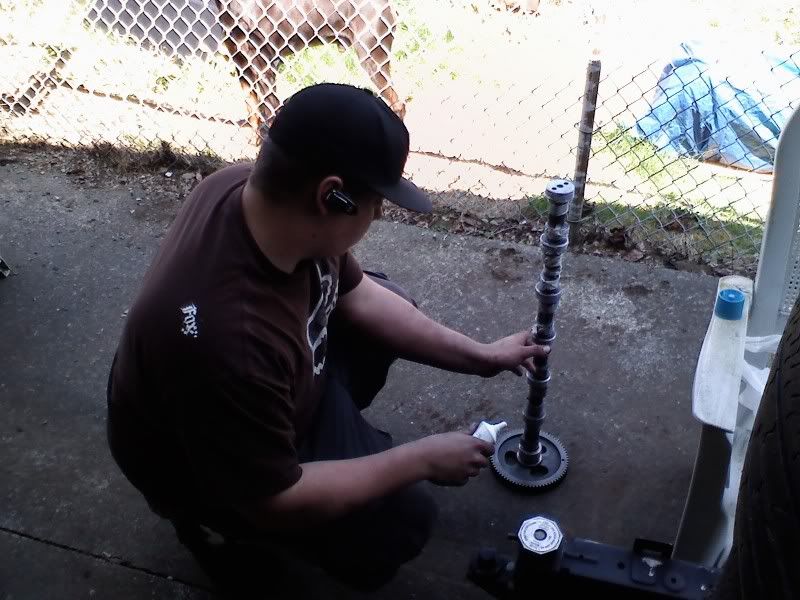

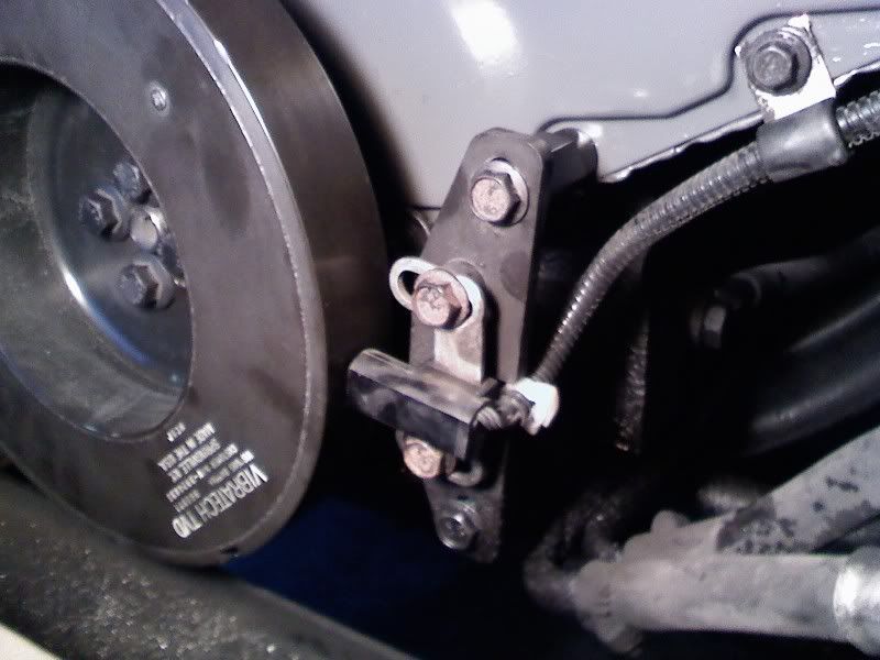

Postby SNOOT » Tue May 12, 2009 6:23 pm
Cam was installed over the weekend... All went well.. I cant wait to get some fuel to this thing!!

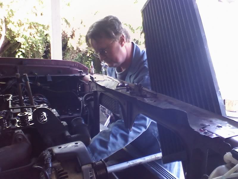

Postby KTA » Tue May 12, 2009 10:10 pm
It is a shame you cut that mint core support to put the cam in. :cry: It looks like you have a lot of nice goodies on there though!! It should be a good reliable runner. Those look like chevy valve springs though is that a dual spring with dampner setup? What kind of seat pressure do you plan to run?
KTA
diesel guru/mod
Posts: 1855
Location: Shelby County, Ky
Postby SNOOT » Wed May 13, 2009 7:01 am
KTA
I will weld the core support back in and post a picture to make you feel better. I cant tell you the exact springs used. lol The builder is anal hush . hush. They are a single spring with dampner. Seat pressure is not super crazy I also have better valve seals installed in they some place.

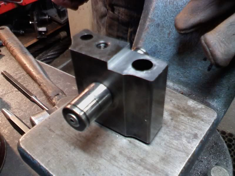

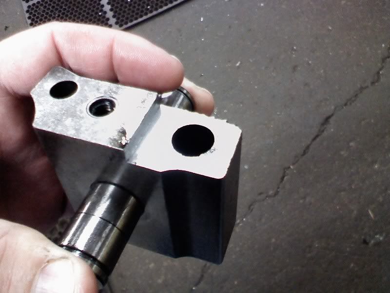

Postby SNOOT » Tue Jun 02, 2009 9:53 am
Man this stuff takes time...
Rockers machined ... Check
Block surface cleaned ... Check
Stud holes tapped and cleaned... Check
