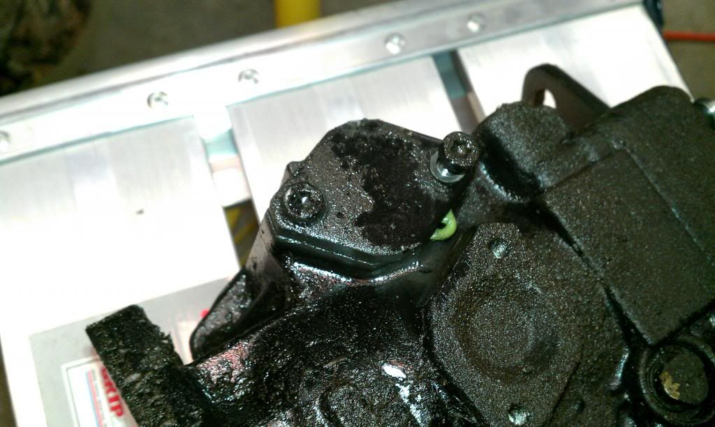

Postby 93DodgeCummins » Sat Feb 09, 2013 8:47 am
I think i found the problem... :roll: Now the question is do I just do a reseal or just replace that o ring and call it good... Also is there any good way to clean the IP case with out getting crap in the shaft area, inlet port, and the delivery valves?

Re: Super sized injection pump LEAK!!!
Postby RCCUMMINS89 » Sat Feb 09, 2013 8:53 am
Replace the o ring and call it a day. Unless you are fairly mechanical and really know what you are doing, taking apart an injection pump can easily lead to problems.
But if you feel comfortable, google "ve pump rebuild" and some stuff will come up...usually on the vw forums, but it'll help.
Postby Mark Nixon » Sat Feb 09, 2013 9:29 am
IF YOU FEEL COMFORTABLE, re-seal the whole thing.
Otherwise you'll be fighting leaks piecemeal, until you either fix them all, or get disgusted and do it right yourself, or buy a new pump.
The ones that are LIKELY to give the most fits are the KSB and it's accompanying rear cover 'O' rings (as you know), the AFC transfer pin and the throttle shaft 'O' ring.
To a smaller degree, the governor shaft seals and the KSB line 'O' rings fail, as well.
MOST guys who do a GS install end up re-sealing the top during the install, anyway.
I've done a few and even corrected other's foul-ups, so it's not a problem for me, but everyone is different.

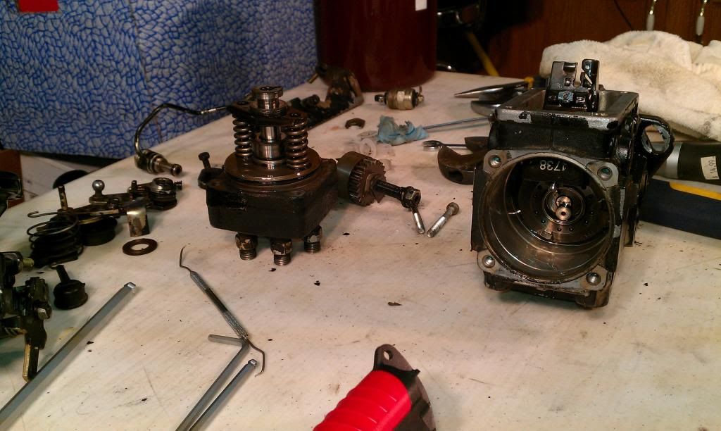

Postby 93DodgeCummins » Sat Feb 09, 2013 7:41 pm
Here is the progress so far!

Postby Mark Nixon » Sat Feb 09, 2013 8:01 pm
Oh boy! A bunch of parts! :mrgreen:
For ease of re-assembly, pay particular attention to the position of the cam plate in relation to the "crank" keyway..MARK IT.
It can go in 180* off and you wouldn't know it until you try to start it.
If you want to remove the bolts for the control levers in the main case, either make a socket from a 6 point 13mm socket, by grinding every other point off the socket (create 3 "fingers"), or lightly tap one corner with a SMALL chisel, then turn them out with needle-nosed pliers.
The AFC lever, in the top, is held in with a pin, which is secured by 2 steel balls.
You'll need to drive one in to drive one out, then drive the other one back out with the pin.
Might not be kosher, but it has worked for me and many others.
Postby 93DodgeCummins » Sat Feb 09, 2013 8:22 pm
Is that Cam plate just behind the pump head? Also how do you remove the delivery valves? They seem to be super tight. I was thinking maybe just touch off an impact wrench on them but i don't know if that will hurt anything... I need to get my chunk of rubber from the fss solenoid out.
93 Dodge W250 4X4, Custom air intake, Diamond Eye 4 inch turbo back straight pipe exhaust, HX-35W with Banks upgrades, KDP fixed, Getrag 5 speed, Isspro Tach, pyro, fuel pressure, and boost. Raptor 150, 3200 rpm spring, Power Screw in 1 turn, aftermarket fuel pin
93DodgeCummins
Posts: 396
Joined: Thu Dec 03, 2009 6:50 pm
Location: Pickstown, SD
Postby Mark Nixon » Sat Feb 09, 2013 8:36 pm
Delivery valves are simple enough, just make sure you have a firm grip on the pump and a quick smack on a 1/2" ratchet should pop them loose.
Air is okay, with discretion.
The cam plate is the item with the dips in it that the rotor (plunger) sits into.
Also, beware of the itty-bitty (8mm) round spacer that sits between the cam plate and the plunger and DON'T LOSE IT!!!

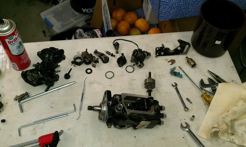

Postby 93DodgeCummins » Sun Feb 10, 2013 11:53 am
Got the pump head off. Im betting thats the little 8mm washer you were talking about?

Postby Mark Nixon » Sun Feb 10, 2013 4:24 pm
Yes, that's the spacer.
Make sure you're documenting how this came apart, for example the ring that the AFC lever's nub rides in.
It has a chamfer on one edge.
It needs to be re-installed the same way it came out, which is chamfer up, towards the head.
