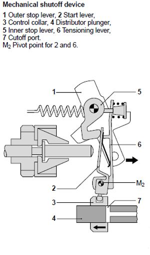

Does anyone know how the fuel stop solenoid cuts off the fuel supply? I'm guess it cuts the flow to the distributor head?

Luther Grimace wrote:Does anyone know how the fuel stop solenoid cuts off the fuel supply? I'm guess it cuts the flow to the distributor head?
The Electrical Shutoff device and the Mechanical Shutoff device are two entirely different means of stopping fuel delivery from the VE rotary injection pump.
- The Electrical Shutoff Device (AKA: Fuel Shutoff Solenoid/FSS) stops fuel delivery to the Head/Rotor (H/R) by way of the rubber-tipped plunger interrupting the case pressure fuel supply feeding directly to the H/R.
- The Mechanical Shutoff Device is comprised of the external lever (No 1) being connected to an internal lever (No 5). When applied, that internal lever works the throttle/governor linkage assembly and has the control-collar (No 3) uncover the cutoff port (No 7) of the distributor plunger. With that, no fuel is delivered to the injectors.
As an FYI: Our typical "Runaway" (or more accurately: Ineffective Fuel Control) issue is a result of the throttle/governor assembly being adjusted such that the fuel control collar can't uncover the cutoff port enough to have the engine RPM come down. It may actually be partially open, but there's still enough fuel being delivered to the injectors that the engine continues to increase speed.
More often than not, the Mechanical Shutoff will shutdown the engine. But, if you've got things WAY off such as after a botched throttle-indexing/main fuel-screw setting for example, the mechanical shutoff won't be able to uncover the cutoff port enough, if at all.
As many times as I've messed with my IP, I've had MANY instances where, after hitting the starter, the engine came alive and clearly acted like it was headed for the moon. I instantly switched the ignition off while pulling on the mechanical shutoff cable. The engine's stopped every time. :)
Still, keep a board to cover the turbo handy when appropriate. ;)

Postby Luther Grimace » Wed Mar 06, 2013 6:04 pm
How does the manual lever shut it off if the fuel port by the electric solenoid is open?
