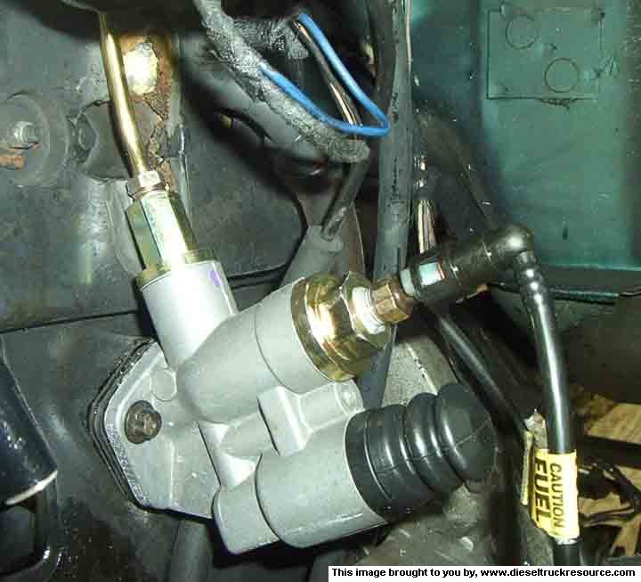

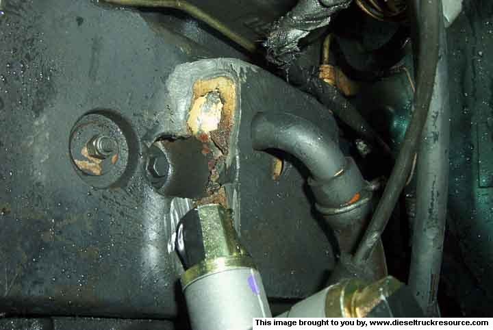

- That item Wannadiesel was talking about in my thread over on DTR was the Injection Pump's fuel return line. Knowing some folks can't help themselves, she mentioned it. It runs just at the top of the lifter noise blanket. Roughly two or so inches above where one needs to make room for the new lift-pump.
You can see it in the top of the following image from that thread.
Regarding using a dull kinfe, IIRC, that was in reference to what one member used. I used a metal burr on an air-powered die grinder. Personally, I thought the fella that used the dull knife worked his butt off making room, never mind working with a dull knife tends to be dangerous. :lol:
With removing the little bit of the noise-blanket, there was plenty of room for the pump though I confess I did have to bend the top fuel line a little to clear things. no big deal.
- With any removal/installation of the 5.9 CTD lift-pump, be it the diaphragm or the piston type, one needs to have the camshaft parked where the lift-pump lobe is not working the lift-pump. having it otherwise only make the job that much harder. It's in the FSM. ;)
- Trimming the noise insulation as shown above, you don't need studs to install the piston lift-pump. With stacking the gaskets, spacer and pump, the stock/OEM bolts are just fine. I did use gasket shellac on the stuff, so they stuck together as one unit upon installation. ;)

I didn't have any problems with it until that point......Sounded to me like Eric helped him with instructions on how to do it...he just didn't follow them....Like I said...I believe the only reason people complain about needing studs is because they don't make sure the cam lobe is away from the lp. once the lobe isn't working against you it butts right up to the block...

I used a 4 inch grinder with a cutting wheel to do mine. I just went slow and if I saw sparks I knew I was too deep and backed out a little. No problems. I was aware I had to cut the insulation before I started, knowledge is power! ;)
