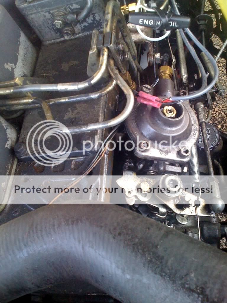

Postby Towriggity » Thu Mar 04, 2010 5:06 pm
Here's how the pump sits in relation to the head

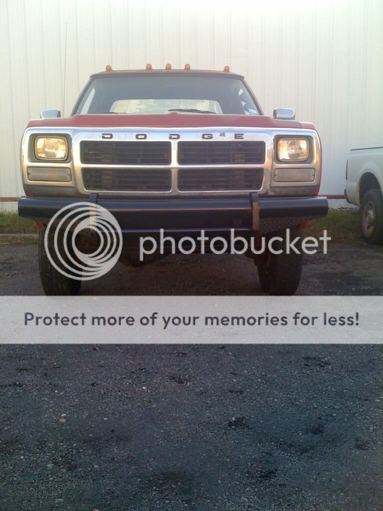

Re: Not the hoss I had hoped for
Postby Towriggity » Thu Mar 04, 2010 5:19 pm
Take it easy on the bumper guys, built it outta scrap one weekend, it's not done yet. :shock:
Postby 1STGENFARMBOY » Thu Mar 04, 2010 6:06 pm
Bumper looks great to me, thats gona be an awsome truck, as my preacher
tells me THATS A MAN TRUCK. :lol: :lol:

Postby Towriggity » Thu Mar 04, 2010 6:36 pm
In regards to the picture of my pump, some people actually push the pump all the way to the head? Approximately how many degrees advanced is that over stock? Seems like a good way to toast a hg.
