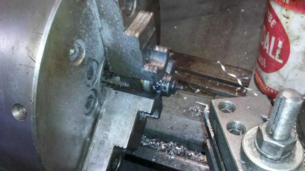

Made a case pressure guage setup today, came out awesome. If you gut the internals of a shutoff solinoid there is a hole at the bottom with enough material to thread for 1/8 pipe, after threading the hole i put a fitting in with flare on the other side and turned it on the lathe so the o-ring on the bottom of the shutoff would still fit.
a ninty degree flare fitting and some 250psi parker pushloc later and the setup works mint.
so far. (all readings with KSB off)
Idle=90psi
2000rpm=150psi
2000rpm+ goes steadily up to a max of 210psi
rompin on it at low rpm =90-110 psi
rompin on it at 1800+rpm= 150- 220 psi
cant wait to see the case pressure drop with some big injectors, im going to dual feed the pump once i see the case pressure drop below 80 or so psi under load with big sticks
on ze lathe:
at idle (yes the guage is now in the cab)
this one goes out to Mr. Toombs , thanks for the idea, my guage is no longer crazy

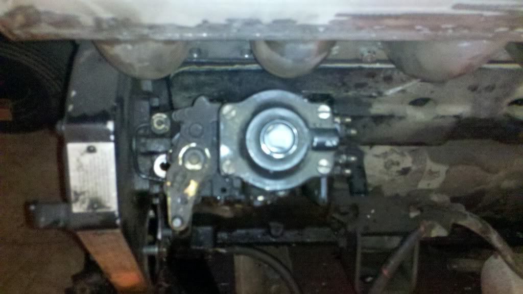

Hey, slacker! Back the high idle screw out and make sure the fuel lever isn't hitting the fuel inlet line!
Damn kids, buy 'em books, send'em to school, all they learn how to do is eat the teacher! ;)
Re: more POWER!
Postby ahale2772 » Sat Feb 26, 2011 7:20 pm
yeah i knnowwwww.... need to do some indexing, it hits the fuel line way before it hits the high idle, seems like it gets all the rpms tho, goes like a banshie and boost drops off fast once the govenor hits, im planning a full rebuild of the fuel system, saying its a mess is a massive understatement, most of it is the old fishermans work. replaced my cable shutoff today, was a cable running to a piece of twine :oops:
