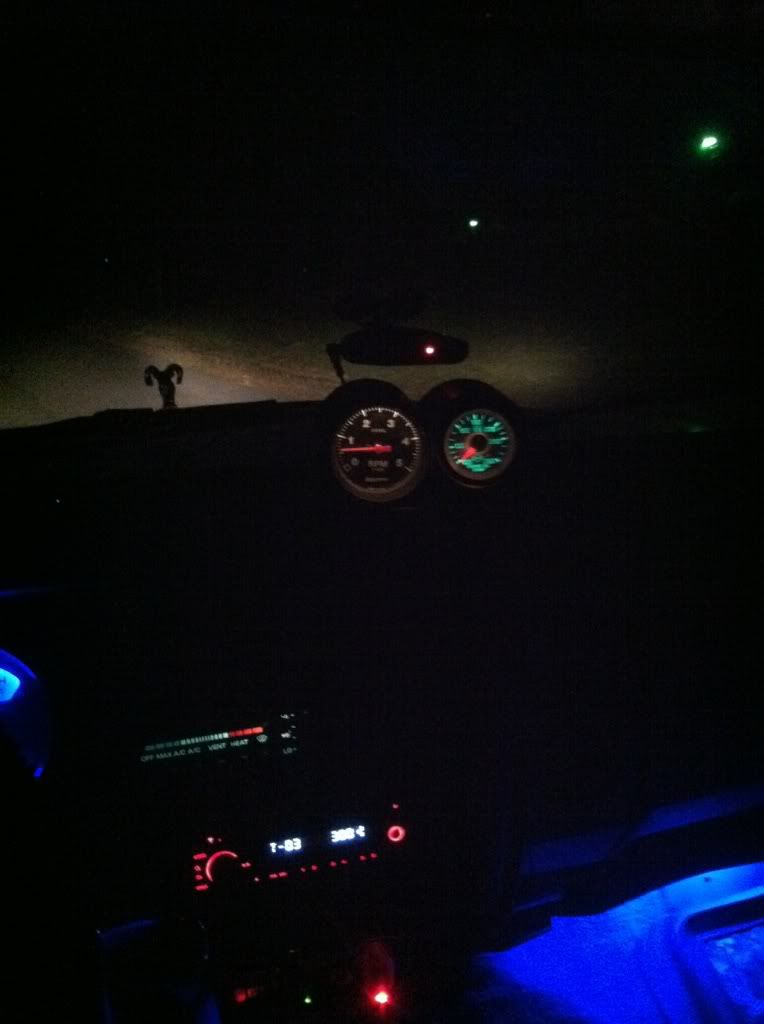

well i diddnt get a isspro like my other matching gauges but i did spend $60 ish on a nice autometer 100psi one. hooked it to the open spot on top of the oil filter housing. mounted the gauge in a nice pod from genos on top of the steering coloume. thanks for the help guys!

Postby skilletky » Wed Mar 07, 2012 11:56 pm
I'm digging the blue dash lights. Are those led? I want to put red in mine.

Postby Tsbourne09 » Thu Mar 08, 2012 12:18 am
yea. all blue led bulbs and wite face gauges (white stickers from whitefacegauges) thanks! they have red
