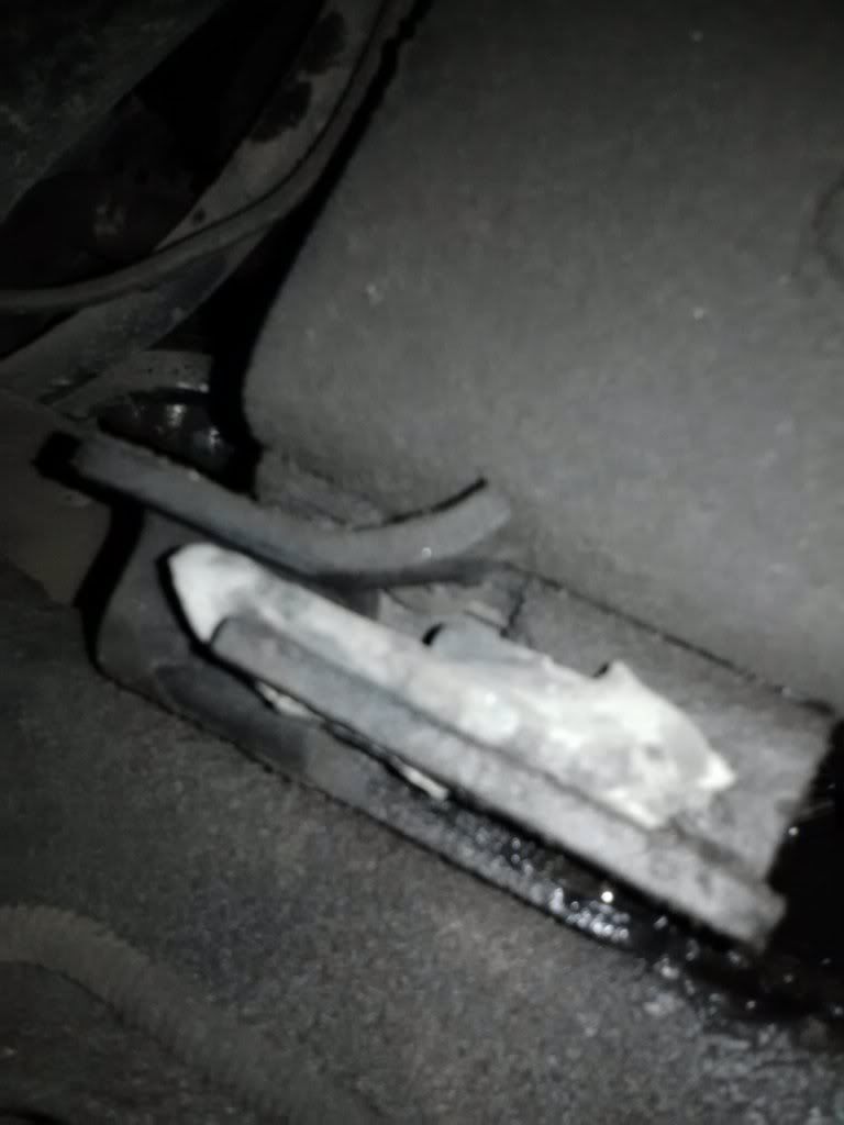

Postby Hansen01 » Fri Nov 02, 2012 4:14 pm
Well, i think its about time for motor mounts
I could see by the rust marks on it that it was about a quarter inch away from being "broken motor mounts" instead of "motor mounts" :lol:
Anyone have a good source for mounts?
Stock ones or upgraded ones?
OR is that bent tab just not important,lol
Re: Motor mounts
Postby m880cummins » Fri Nov 02, 2012 5:32 pm
The tab should be there, I'm not sure if it should be bent like that but the two tabs should be insulated by a piece of rubber between them. The tabs keep the engine from ripping the mount from too much torque. Those don't look too bad but a replacement is $20 from most auto parts store. I have had no problems with stock fronts but I always use poly mounts by the transmission. They hold up better to oil residue and vibration out back.

Postby Hansen01 » Fri Nov 02, 2012 6:00 pm
Nah its not spose to be bent, :lol:i went and looked at Dads 93 and they are strait.
Didnt know if anyone made a mount that wouldnt bend like that

Postby Hansen01 » Sat Nov 03, 2012 6:41 pm
I read you write up on dtr BC, and followed some links from there and decided to order some from rock auto for the time being. I chose the one on the far lefthttp://www.dieseltruckresource.com/dev/showthread.php?t=158399
As you can see the napa ones look like cheap piles of junk.
If i break and bend these il get some polys next time. Not ready for any extra noise yet :lol:
