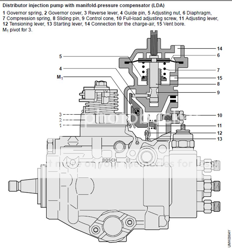

Ok so I had a fuel leak caused by my lack of a fuel pin which caused guide pin 4 to be pushed out.
I just pushed it back in and it took a wee bit of force, I'm assuming because it was all the way out, and when it went it went. Now it appears to be stuck in the all the way in position. I still haven't put the fuel pin in but I took it for a spin and it was a dog. I got back and took the cap and diaphragm off and its still tightly in there.
No smoke, No power. Any ideas? :scratch:
I mean I know I have to get the pin back out and free moving but whats gonna be the best way?

Ok I got it. It worked its way back out.

Postby bubba » Sun Nov 18, 2012 8:28 pm
I just drove it. The pressure pushed it out the first time and it got it to come back out. Now I just need to figure out what pin I want to use...

Not every one. Some people have a problem where the Stage 2 is to deep and allows the pin to come out to far and the fuel leaks past the oring. They say a stock ground pin fuels as much as a stage 2 only it won't allow the pin to come out to far.
