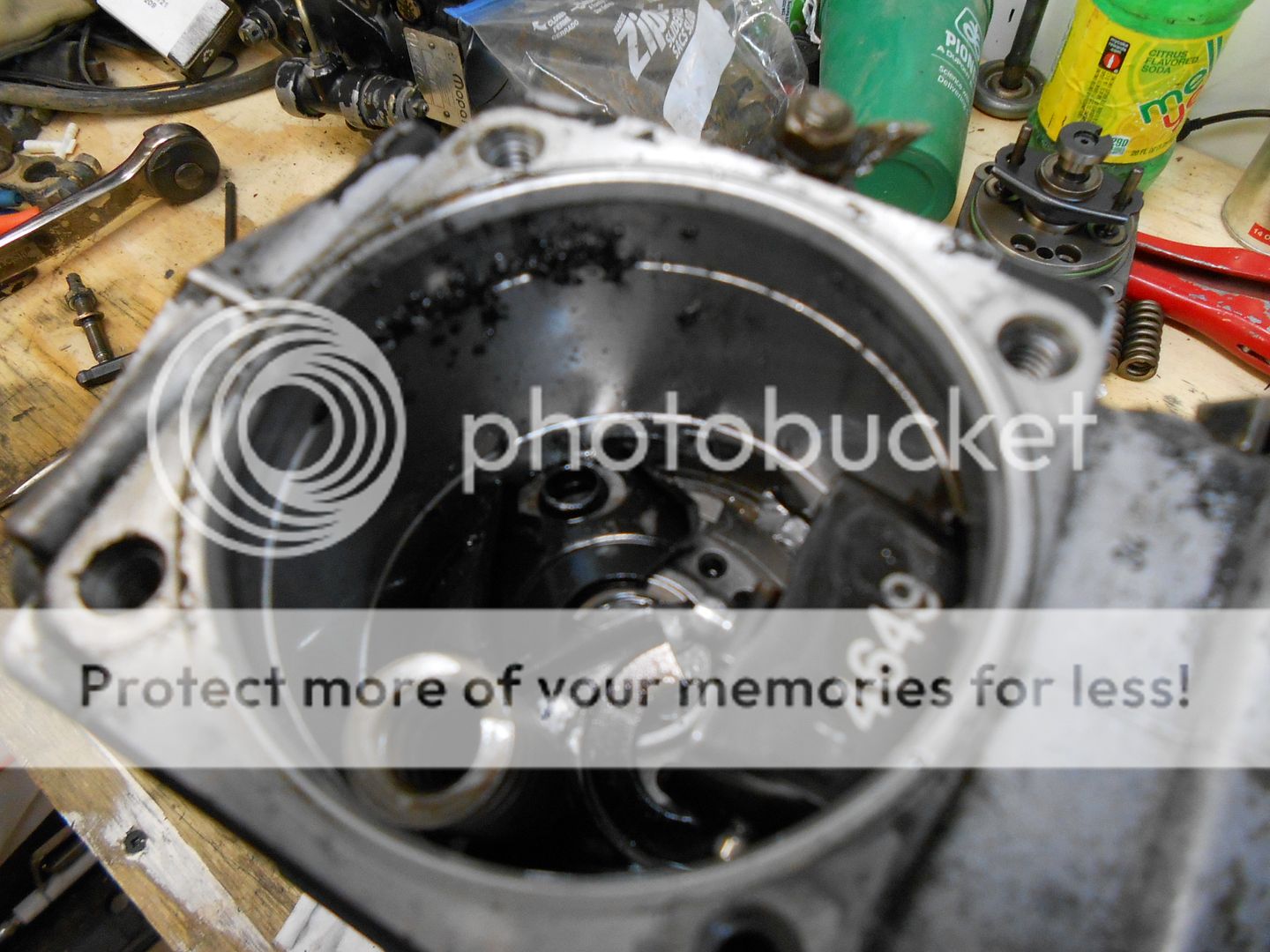

Postby pulltilbroke » Sun Dec 09, 2012 10:05 pm
Pump off my 90,

Postby cmann250 » Mon Dec 10, 2012 5:59 am
Is that due to the flux capacitor putting out too many jigawatts?

Postby pulltilbroke » Mon Dec 10, 2012 6:15 am
No its from me screwing something up upon ressembly. I've had the pump off the truck 4 times this week. We now have a 205 pump on it I built. It doesnt run near as god as the 114 pump did though

Postby Philip » Mon Dec 10, 2012 7:02 am
Looks like you made a few extra parts. Thats not good.

Postby Remps » Mon Dec 10, 2012 7:46 am
By 114 you must mean 184 pump? Must've quit running in a hurry from the looks of it.

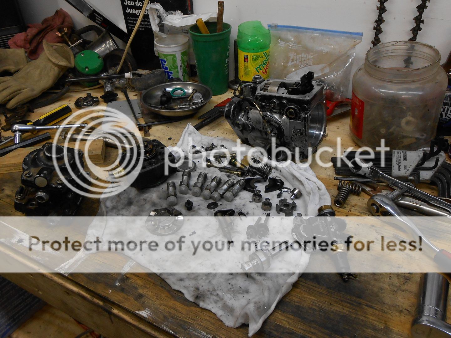

Postby Mark Nixon » Mon Dec 10, 2012 1:43 pm
Not slamming anyone, but I'm betting trying to turn it over before installing it would have produced a binding or stopping point in it.
You don't get damage like that unless something came apart, or was bound up in the first place.

Postby sxd217 » Tue Dec 11, 2012 10:59 am
Mark,
While you have this nice picture of parts would it be possible to point out the Head and Control Springs?

by Mark Nixon ยป Wed Nov 14, 2012 4:15 pm
Head and Rotor control springs.
Actually, I mis spoke, they are rotor control springs, bad habit on my part.
These have broken and can cause the pump to function erratically.
