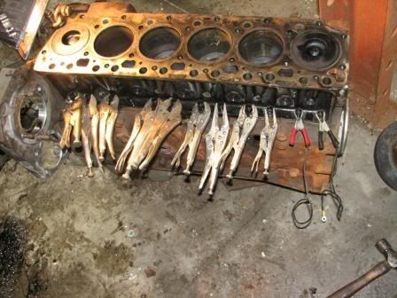

Or you can use Vice Grips like someone on here who shall remain nameless. ;)

That's my job buddy! :jocolor: I wasn't gonna tell him, you gave yourself up! :jumpsmile:
Postby mprmn08 » Mon Jun 09, 2008 5:06 pm
not only vise grips but 2 battery charger clamps also. he's high tech!! :wrench: :thumright:

Postby cummins king » Mon Jun 09, 2008 7:57 pm
I know its just your job, haha
Its okay i still laugh about it with my budy
