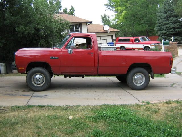

Would you really notice a difference given the same situation? I just bought a bone stock 1991.5 W250 4x4 IC Auto-O.D. and it really seems doggish. I'm only comparing a "feel", but compared to my almost stock 1-ton DRW 4x4 Auto, it seems sluggish. The Dually has an 18cm, the W250 has a 21.
It just rained and I know my dually could break the tires loose, but the W250 wouldn't even think about it. Just felt like little or no boost. Don't have a gauge yet though.

boost difference should only be a couple of pounds. SO I HAVE HEARD. and the 21 takes a little longer to come online.

very big difrence, give the fuel screw a few turns and get a 16cm exaust housing and you will light them tire up easly
nice clean looking truck by the way

I remember thniking right after I got mine, "this cannot be the truck those guys are talking about on the web forums." A few cheap parts and a couple screw turns later made all the difference in the world. 366 spring is the biggie for a stick truck.
