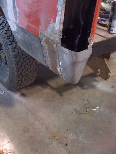

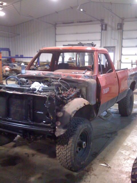

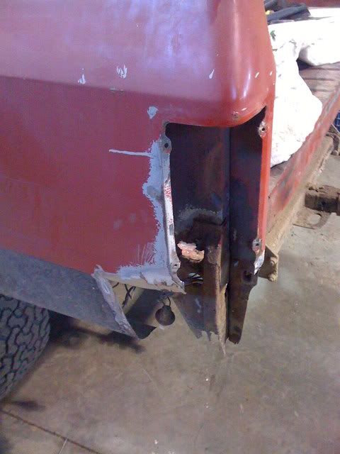

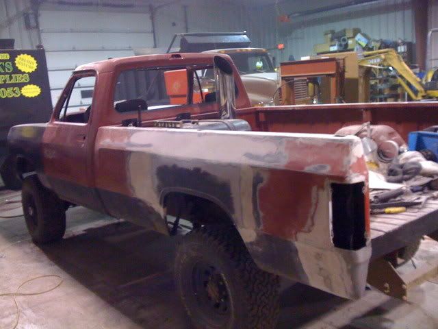

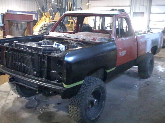

As some of you might know my truck was starting to get a little ruff looking so i did a bit of body work. I didn't go into to it like most of you guys do these are more of easier fixes. Im no pro at any of this stuff.

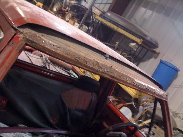

so i started cutting everything up
I did basically the same things for both sides.

Postby cummins king » Sun Mar 01, 2009 3:20 pm

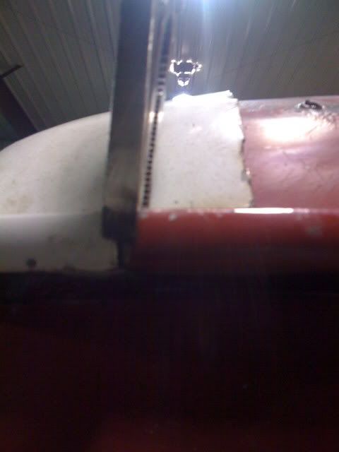

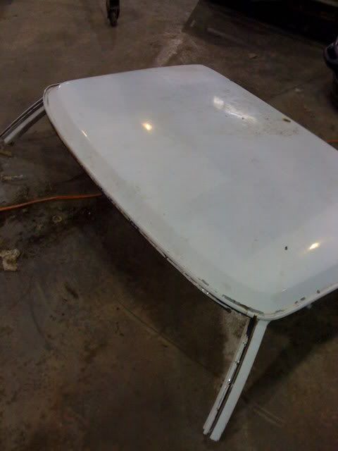

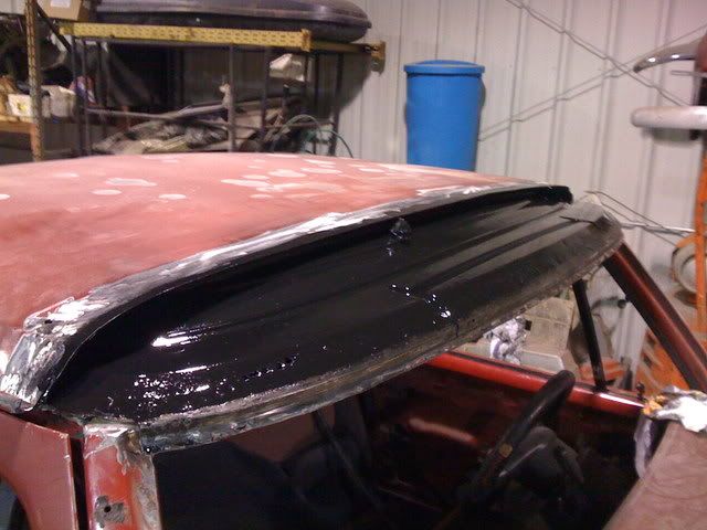

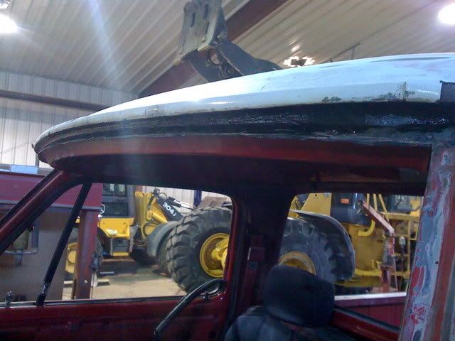

the i started to put everything back together and welded on
in the last picture you can see what i did with the roof
i got the roof piece from a rust free cab at a scrap yard

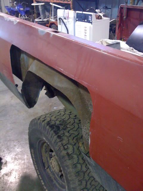

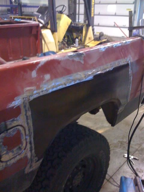

Postby cummins king » Sun Mar 01, 2009 3:33 pm

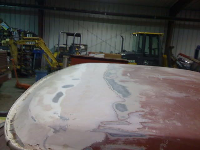

Then it came time for some bondo and a lot of sanding!
Again i did that for both sides

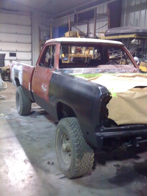

Here is the passenger side almost complete
then is started to paint. I re rubber guarded the bottom, and im going to prime and paint (i hope) this week.
I have a good spray gun and i'm building a temporary paint both.
I'm going to paint it Red again.
How would you guys recommend me to paint the truck. I was thinking Base coat clear coat, But i think with will show to much of the imperfections. I was thinking more on the lines of Base coat, and a Shine coat, what do you think?

Hey i noticed that you live in Ontario, Where abouts?
Basicly for the roof i cut it out got the grinder to it and wire wheel and i got as much rust as i could out then i painted the inner roof with rust guard paint
Then i lined it up as best as i could and clamped it down and i spot welded it all around.
After i got some seam sealer from Napa and i sealed the seam where the window rubber goes.
The i bondoed the top and sanded it down. It looked really good.

The thing that shows inperfections is darker colors. If you paint poor body work white it still looks pretty good. Paint it black and WOW you can see everything. Basically everything I paint should be white. :lol:

I just had a guy come by today and cut the roof off my original cab. His was shot too.
CK, you should have blended the new top into the truck at the pillars, (replace the whole top) instead of where you did. That would have gotten rid of all the rust up there. I hope it doesn't come back on you.
Looks good so far. It should prolong the life of the truck quite a bit.
Keep up the good work! 8)

I think i got all of it the inside roof has no rust so it looks okay, but
thanks PT, i think that's the most constructive criticism you've ever given!

Personally I don't think single stage paints are any easier to work with than base clear. If you want a single stage, I'd suggest a urethane and spray as many coats as the spec sheet says. You want some thickness in case you need to wet sand and buff it, but to thick and it won't cure right. You can clear over most single stage paints too, but there is more prep work. If you think you might have to buff it, stay away from any metal flake paint. When you get all set to paint, spray some scrap metal to dial yourself in with whatever paint you're using.
Where did you get your patch panels? Are they close to the same thickness as the factory metal? How's the fit?
