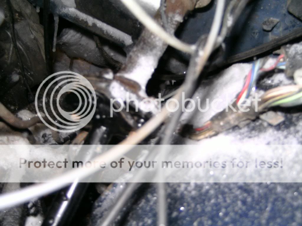

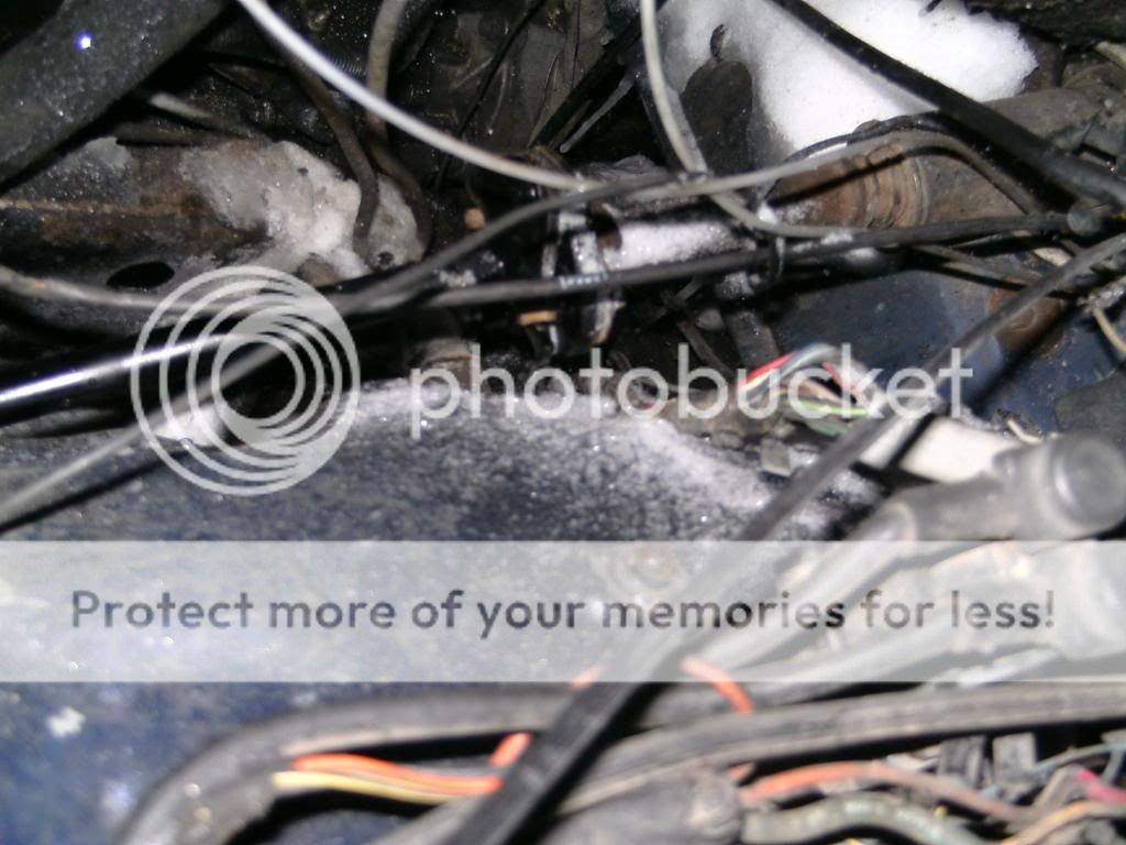

Postby pulltilbroke » Tue Dec 08, 2009 7:46 pm
The joints are available from Speedway motors
This is the joint I used
http://www.speedwaymotors.com/Speedway- ... ,6632.html
The shaft I used was out of an 86 gasser. It was 2 1/2 inches longer then the original shaft off of my truck.
The gasser shaft measured 19" from the column side of the rag joint with the rag joint still installed to the spot where the shaft necks down, whereas my original shaft measured 16 1/2 from the same points of reference.
I cut the shaft at 18 3/4 and the shaft side of the yoke is at 17 3/4(where I welded it)
I'd go out and take some more pics but it too friggin cold and theres about a foot of snow on the ground

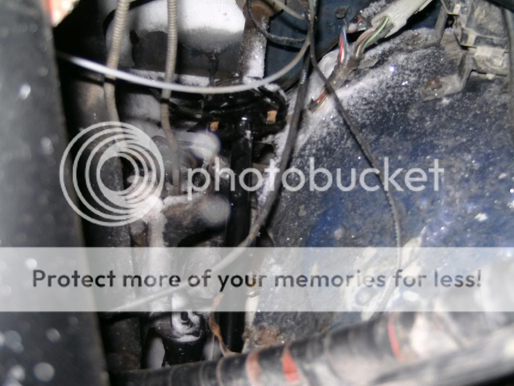

Postby pulltilbroke » Tue Dec 08, 2009 9:02 pm
Okay I lied I did go out and snap some more pics just cuz I had to run up to the gas station to get a Milky Way and a pack of smokes

Postby 1STGENFARMBOY » Tue Dec 08, 2009 9:55 pm
do you still have the rag joint in there i can't tell (you are sooooo deadecated to us ) :lol: luckily i'm just a little south of that cold weather it's just rainin here :)
Postby pulltilbroke » Tue Dec 08, 2009 10:16 pm
Yep, Rag joint is still in there. kinda covered with snow in the pics
