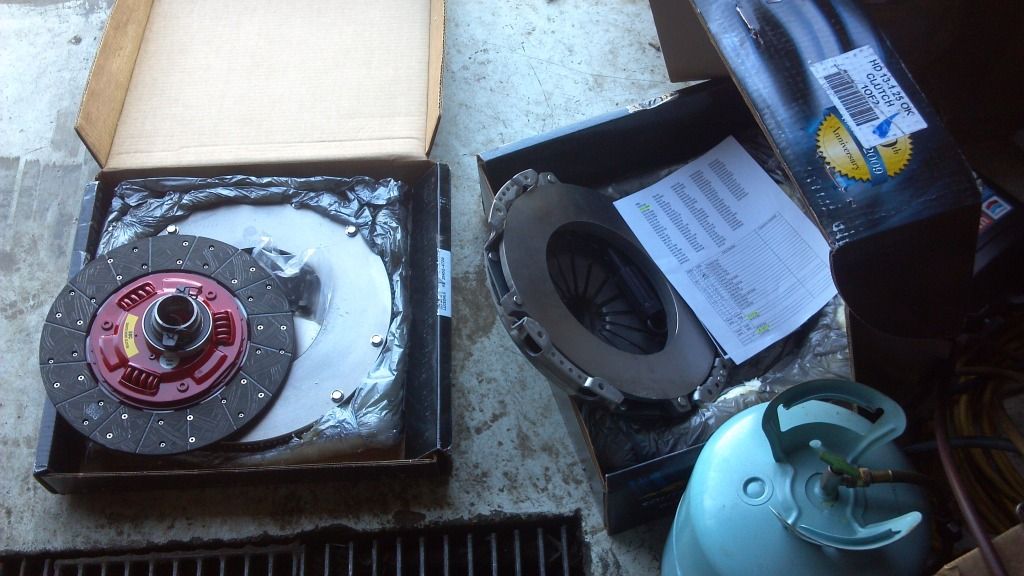

Postby ellis93 » Wed Mar 13, 2013 1:59 pm
Well.....
It's here 8)
Re: clutch time
Postby dazedandconfused » Wed Mar 13, 2013 2:01 pm
Who's clutch?
