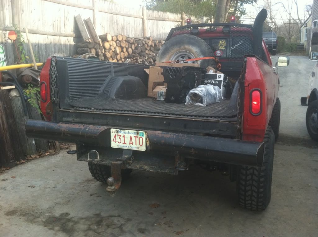

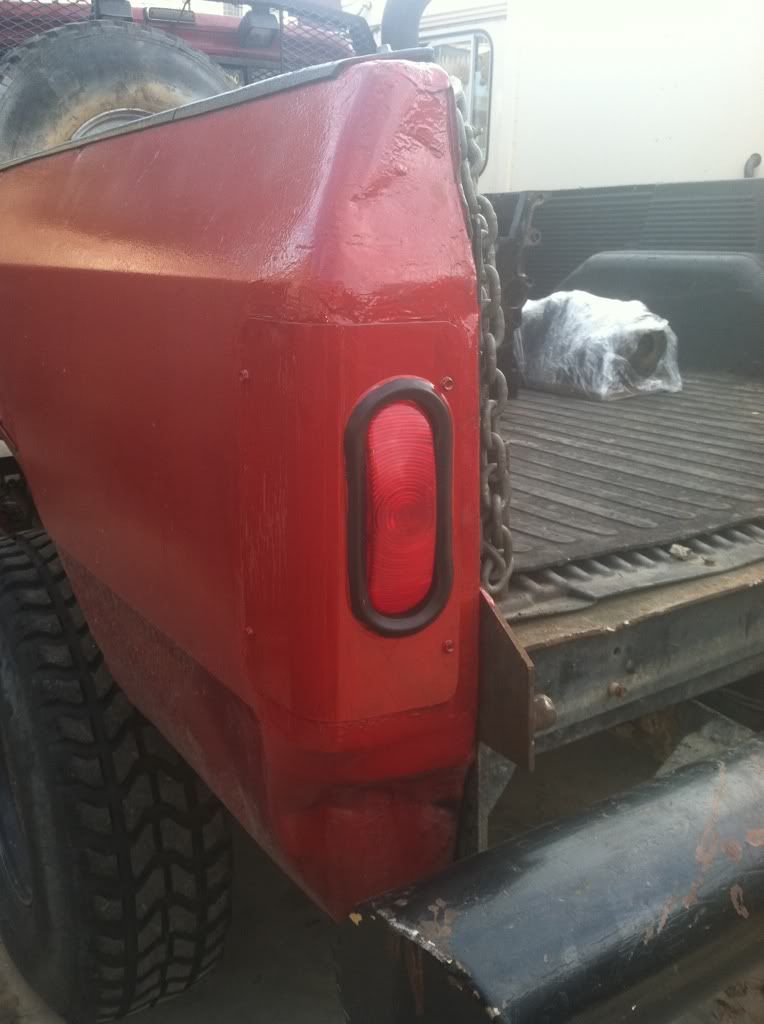

I finally got sick and tired of my taillights, they stockers look good, and I like them, but them GAWD DAIMM sockets kept rotting out!!
ive been through three sets of sockets, one that were completly rotted and two that were ok.... but then had rotted off contacts :mad:
anyways, many may hate what these lights now look like, and I'm kinda still warming up to them. i made them quick, whole job was T minus 1hour including wiring 8)
they are simple stop tail turn lights from a tuck supply place, came with the rubber gromet, harness and light for 9 bucks a piece.
wired them up simple, taped up my back up lights (have some mounted on my back rack anyways), going to LED ones soon as I pucker up and buy nice ones
bent up the sheetmetal plates, used the stock taps and nut-certs from the slock lights, the left one came out ok, the right looks like crap. my bed is 100% hacked from the previous owner (i have done zero body work to the truck besides paint) so the lines are all Effed up
anyways... go ahead tell me they look ugly, I dont care because they work 8)

That will work Alex but you now have a new problem. The OEM tailights have built in side marker lights. So what are your intentions for the required rear side marker lights?

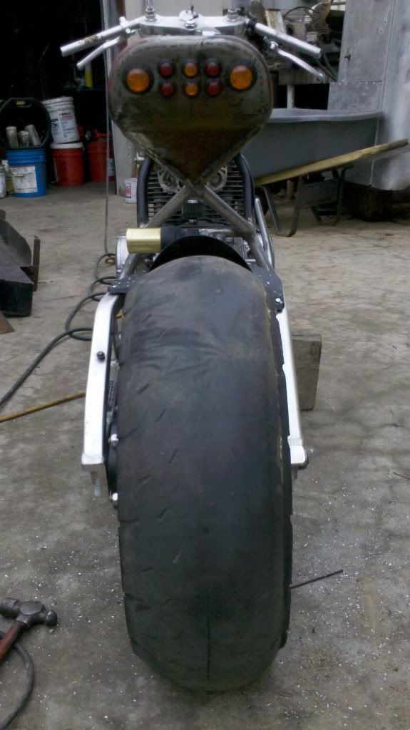

Yeah, I kinda figured that :| ,if i get stopped, ill use the same lights that I have at the very top of my back rack, maxima makes them they are about 3/4 inch with the rubber grommet, very small but you cant miss them.
same ones I had On my bike
still... Im glad I dont need to deal with those stock sockets

Alex, I think your bike needs a tire. :lol:
