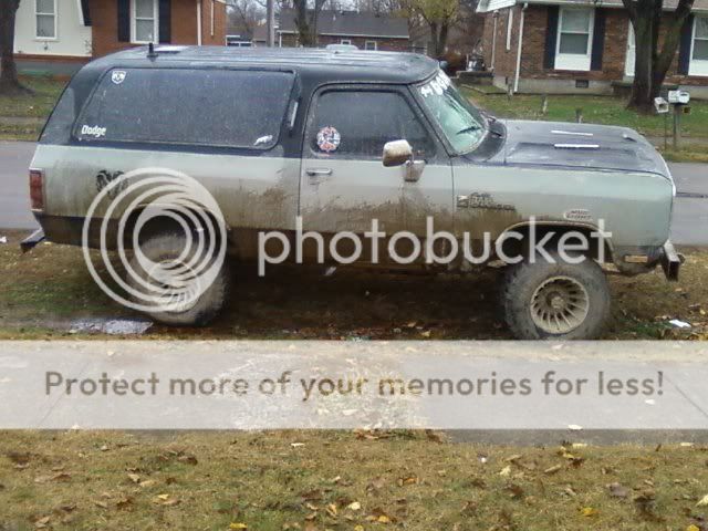

i have put the birdbath hood on my 89 ramcharger you do have to change the wipper cowl and use the latch for the birdbath hood heres some pictures of the hood and latch Image Image Image
