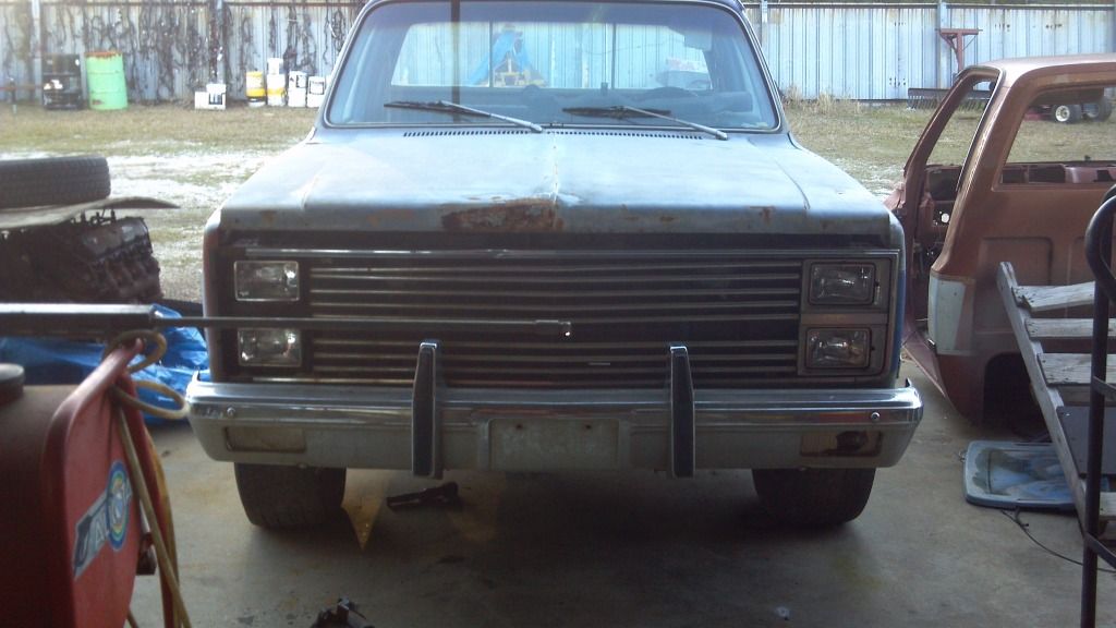

Figured I'd post up what I'm working with,the old Chevy is in terrible shape,so bad I don't even know if it's even sane to fool with :lol: I probably should of scraped it 5yrs ago :/
I've been saving another cab with good rockers for it for the last 2yrs,its been without a bed for the same amount of time. I have it....in pieces...in a pile :lol:

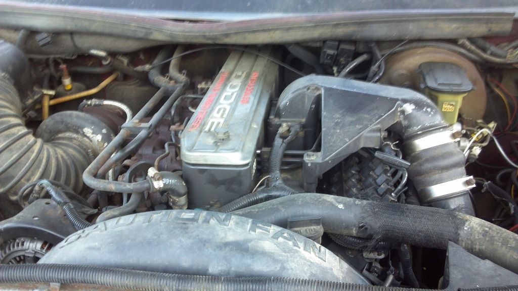

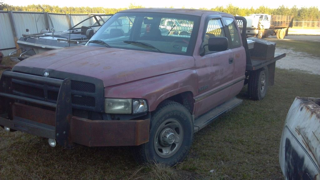

This is what I'm killing 8)
Sad thing is that this truck is in better shape than the Chevy :lol:
This right here
Is all I want....that and the trans
