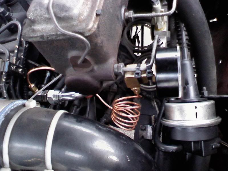

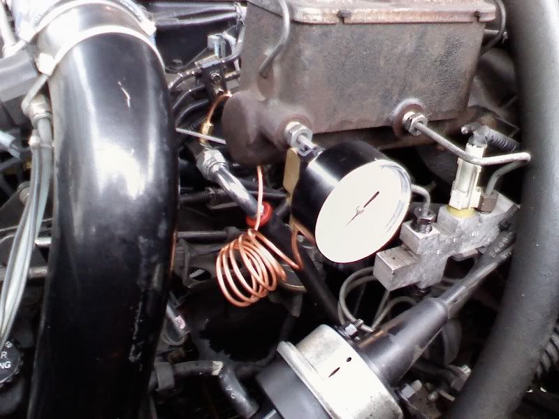

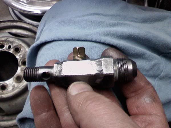

Postby SNOOT » Tue May 12, 2009 6:33 pm
I am using a raptor 150 pump set at 14 PSI. I have a fitting I made that supplies fuel through the inlet on the manifold.
Also have a check valve in the electric fuel pump system in case it stops working.
1993 W350
SNOOT
Posts: 609
Location: Seattle, WA.

Postby BC847 » Tue May 12, 2009 7:58 pm
You might consider slipping a small sheet of plastic or leather in between that hydraulic brake line and that brass assembly. I'd be scared that a hole might get "worried" into the brake line. Or just mount it somewhere else.
Keep an eye on that soft copper tubing. It's gonna fracture. :shock:
