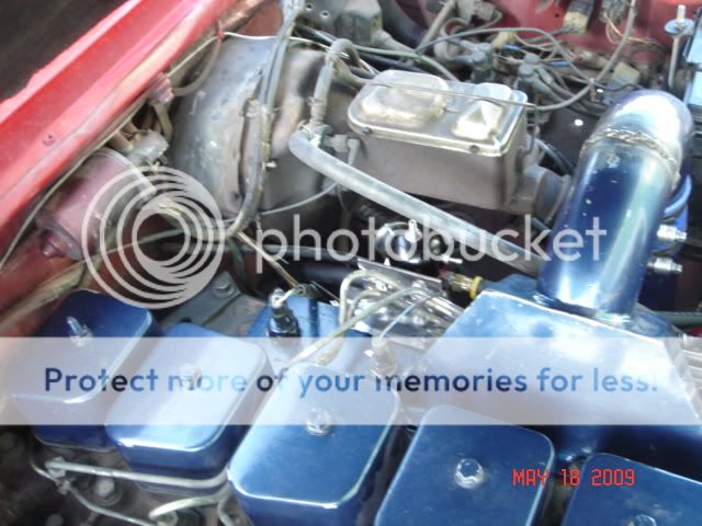

Postby soggy » Wed May 20, 2009 9:15 pm
Pics of the regulator.
For the return I used a fitting that was left over from my brothers Airdog kit. It was for the drawstraw but he went with a sump also.
Although I didn't really do this mod to get me more power( it was more to be able to support lots of power) I did notice it is way stronger on the top end. Also a little more boost and higher egts.

Postby SChandler » Thu May 28, 2009 5:48 pm
Nice setup, that should be able to support lots of HP. Looks like a clean install. What filter head did you end up using? It has 1/2" fittings, right?

Postby soggy » Thu May 28, 2009 9:36 pm
I'm not sure, I went to the local napa and told them i needed a big filter and the head to go with it, yes they are 1/2 in fittings.
