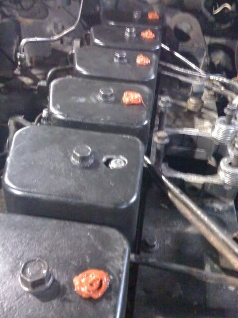

You could just drill a hole in the valve cover and seal it with some pretty blue silicone like another member did. :lol:
Postby peobryant » Thu Aug 27, 2009 6:25 pm
PToombs wrote:You could just drill a hole in the valve cover and seal it with some pretty blue silicone like another member did. :lol:
I don't see any blue Pete. :rambo:

Yeah Parker, I didn't search to make sure I had the right color. Damn silicone police! :roll:

Grind'em, cut'em ,jb weld'em and throw the vanity cover back on..Mine are just ground right now,but you have to be just right for them to seal.Ezra
