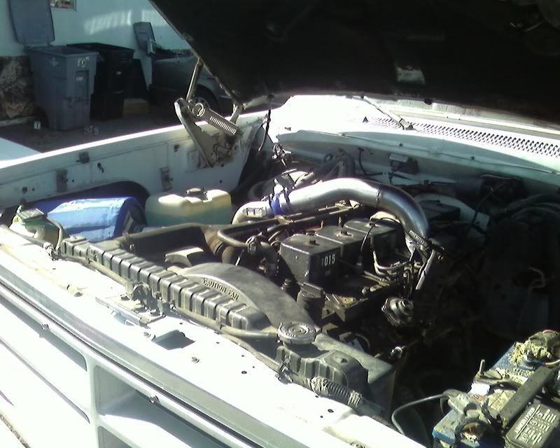

Finally got my 60mm h1e/h1c hybrid on with a 16cm3 pdr ported housing. I also fabbed up a cross over pipe, deleted the grid heater, and threw in a denny t fuel pin. All i can say is HOLY SHIZZZZZZZZZZ. LOL, Less lag than the baby h1c and 18.5 housing, 0-10psi is a little laggy then from there it just shoots up to 40+ psi in no problem.
There is also gratuitous amounts of black smoke too. No barking and no surging, i need more smoke screw and i'll see where the egt's are. I got a couple crummy pics of the setup.
89 D250- G360, Bombed VE, BHAF, 4 inch turbo back, 60mm h1e/h1c hybrid, 16cm3 pdr ported housing, custom 2.5 inch crossover pipe, denny t stg 2 fuel pin, piston lift pump.

Postby DoWhat? » Sat Jul 25, 2009 11:22 am
Spiffy... i just did mine yesterday

Postby DieselSharker » Fri Oct 16, 2009 1:17 pm
Time to revive an old thread instead of starting another one. Where are yall getting those clean crossovers at? I can get a h1e for $50+ shipping and I'm probably going to order it tomorrow. Just want to know what's all entailed as far as the crossover goes. I can put one together but that looks so much cleaner and probably flows a bit better too. Poor me doesn't have access to a welder anymore :(.
1991 W250 727, 6" Skyjacker, 37" Dick Cepeks, Gear Vendor O/D, SDX 5x.014s, BHAF, home-made 4" intake, VE tuning & DennyT II pin, GDS 60mm with 16 cm, CoolerTubz 3" crossover

Postby RSWORDS » Sat Oct 17, 2009 8:50 am
huh... Tht turbo looks like one I used to run... :lol:
The crossover are home made.
