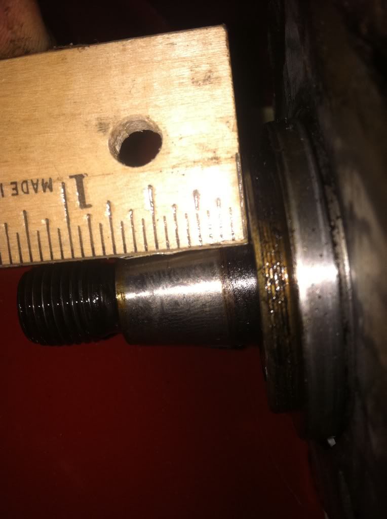

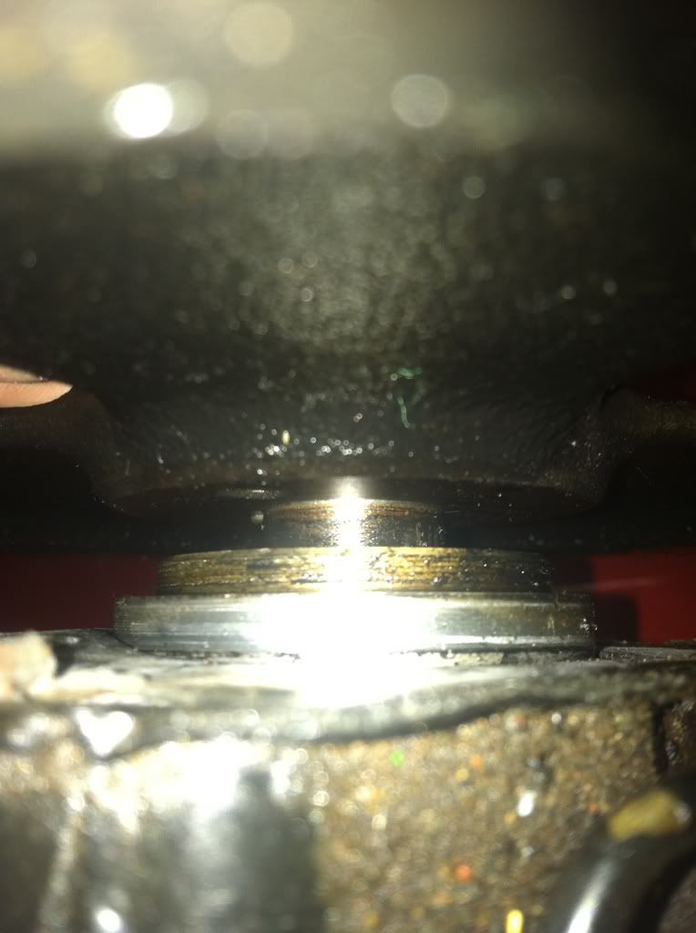

BTW just measured my spare pump for seal retainer clerance....WOWZERS
i seamed to remember there was more clearance...woops...
yeah I know...wooden ruler isnt so accurate...
looks like there is only about 3/16 of clearance.... mine spins over fine, and with the gear locked down, and the pump loose on the 3 pump mounting studs, it wasnt binding at all.... guess I should have checked before just widdling down a retainer and calling it good :lol:
whatever... it works, there is no binding, I ain't skerred 8)
