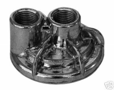

well im almost done my twin biuld,
i just wanted to show you guys this
it should be alot better then cutting the filter housing up

I Just wanted to say, from my experience with the remote filter, that I am planning on rebuilding all the plumbing for my twins. Why? To put a factory filter mount back on. I feel that the extra 60 inches of 1/2 line for my filter set up contributed to my engine going bad. Although I have no evidence to back my claim, and others run remote filter systems, I honestly think that I lost to much volume of oil and in turn there just wasn't enough oil for the end of my engines oiling system, # 6 rod bearing and 6 & 7 mains. I feel that the remote system can be made to work, but bigger line sizes and a bigger remote filter head is needed. (I used a wix automotive style with a filter comparable to stock size.) I also wondered if another factor was having too large of an oil line to supply oil to the second turbo. I don't know. I just thought I would share my thoughts after going through it. Just be aware!!!!!!!!!!!!

i was thinking about that, i have a perfect place for my filter to go thats only 10inches away and ten back, but i dont know if the flow of oil would change, im going to up grage to 3/4inch lines
im wondering if its harder alot harder on the oil pump and it can pump the oil that much farther and then to two turbos

Cummins makes a factory remote oil setup - uses number ten lines
Where the remote oil filter setups liek the ones you pictured fall down is that if you look inside the adaptor the holes are about half the size of the lines and that is what causes low oil flow.
There are good adaptors out there but they are expensive, as in two to three times the cost of one of those mickey mouse cast aluminum things they sell for under a hundred bucks
Get on Ebay and buy a used nascar oil filter housing, some good number ten or twelve lines, proper fittings and if you watch you will come across a custom made billet aluminum adaptor that doesnt have the small hole issues
Ones with the lines coming from the side of the adaptor tend to have better flow tha ones that exit from the face

im going to do some honnign on the filter head to alow lots off oil and if i can i will enlarge the holes to 3/4 NPT, and my local auto store is getting me a race filter head with an ac delco filter, i will probaly us 3/4 NPT lines and it sould be good, that will lower the presure but the flow is better
