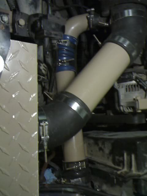

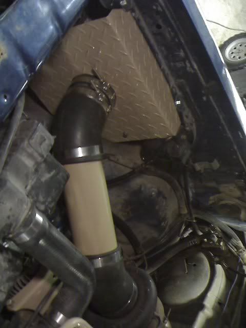

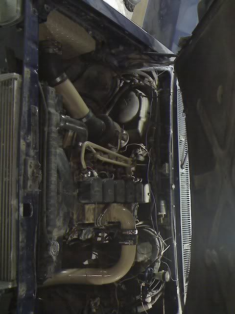

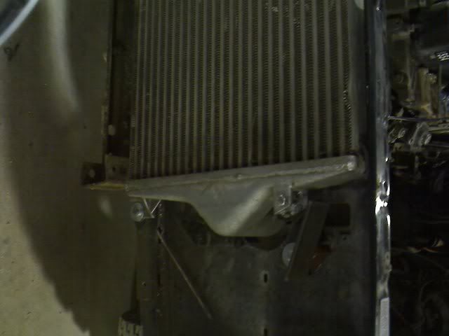

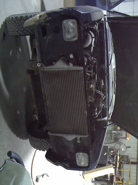

Postby rbrettctd » Sat Feb 16, 2008 9:29 pm
Some pics of the install. Gotta move the radiator tomorrow to make clearance for the boot, gonna try to find some bigger clamps for the intercooler boots, the 3.25" od is just too big for my clamps. Also gotta order a 30* 3" silicon boot for the rubber boot you see on the hotside, its a wierd angle. Other than that, I should be good to rock and roll.

Postby cummins king » Sat Feb 16, 2008 9:44 pm
starten to come along

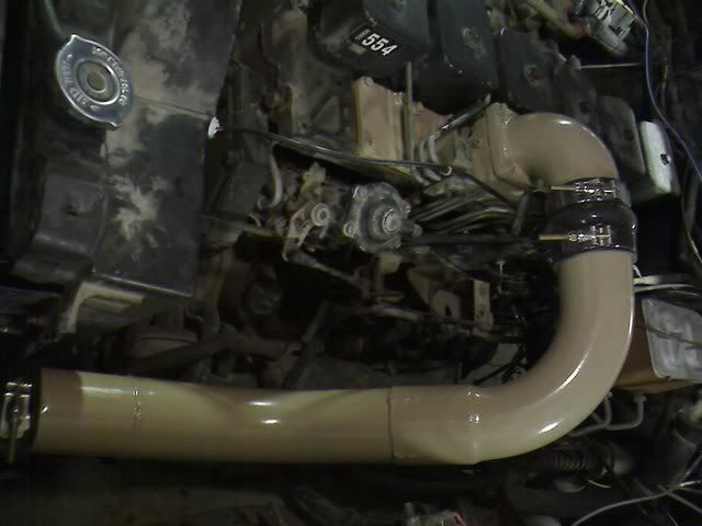

Postby rbrettctd » Sat Feb 16, 2008 9:47 pm
Yes sir. I know the tubing doesnt look that great with the bell/welds in there, but it works and was easy. Man I cant wait to get her running again!!!

Postby cummins king » Sun Feb 17, 2008 6:46 am
oh it looks fine, but i was doing some mental cuculations and will the hood still close, it will be very thight. :oops: :lol:

Postby Ace » Sun Feb 17, 2008 7:58 am
I had to grind a 1/4" off the bottom of the safety catch to clear the top of my PS IC.

Postby rbrettctd » Sun Feb 17, 2008 9:21 am
Any 99-03 7.3 cooler will work.
As for the hood, I was able to shim my cooler out enough that the safety latch clears.
And Joel---I made this one just a hair shorter than the 2.5" horn I had. About 1/16" of the silicon hump hose on that one touched the insulation, but i am a bit worried about the slope of the hood to the side. If it rubs, I may have to swap the hump hose for a straight one, or cut the insulation a little.

Postby rbrettctd » Sun Feb 17, 2008 10:50 am
cummins king wrote:oh it looks fine, but i was doing some mental cuculations and will the hood still close, it will be very thight. :oops: :lol:
Well I went and stuck my foot in my mouth----the boot did hit, so Ive got it ready to weld together up there, just waiting on my welder to get back from church.

Postby rbrettctd » Sun Feb 17, 2008 12:14 pm
Well my "welder" (yes my dad) looked at it and told me try it anyway...so I put some grease on the boot top and shut the hood, and low and behold it barely hits, so Im just gonna trim the insulation and live with it. I will take that other half of the grid heater though Joel. How did you cut it?

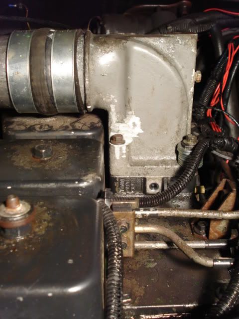

Postby cummins king » Sun Feb 17, 2008 1:03 pm
i dont fallow, that 90o came off of a 5.9 cummins in a ford
93 4X4 auto
cummins king
Posts: 1741
Postby rbrettctd » Sun Feb 17, 2008 1:33 pm
Where the wire loom is going in it? Looks like the whole top is cutout. Could be my computer playing tricks on me....
