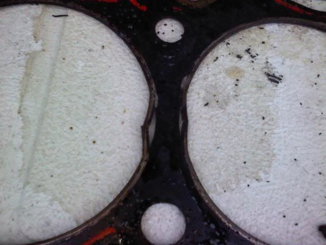

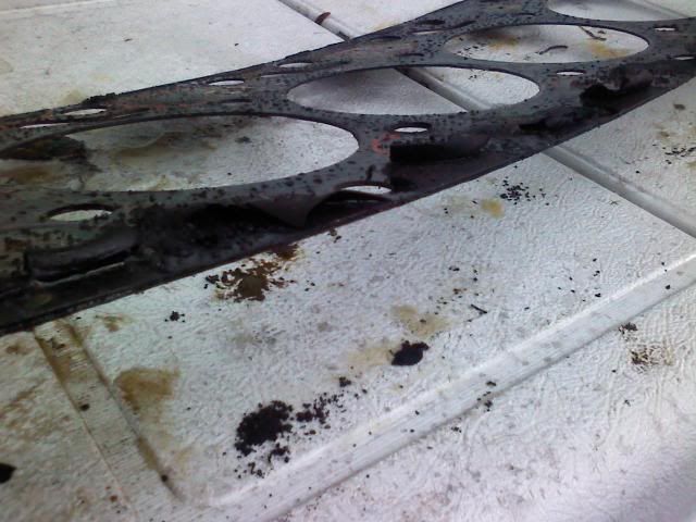

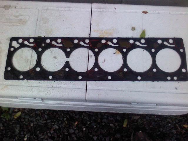

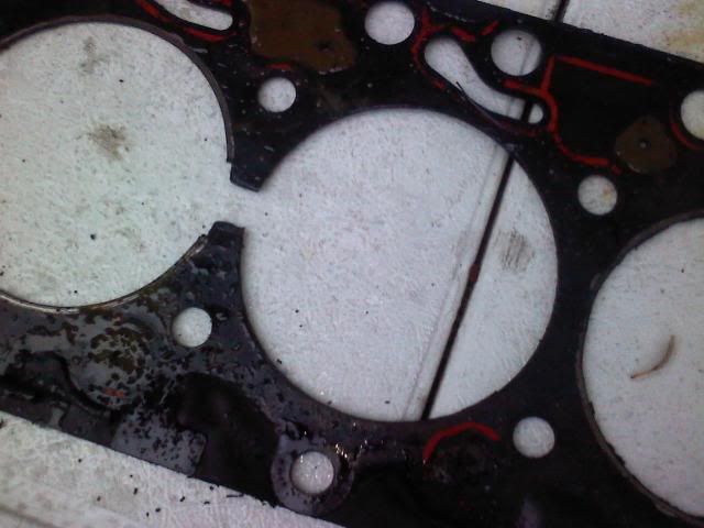

Postby RSWORDS » Thu May 07, 2009 7:33 am
Here are some pics of mine. Right between 4 and 5. Looks like a few others were ready to go too.
Why is this peeling up like that?
And also... Were did that little piece of the gasket go?
