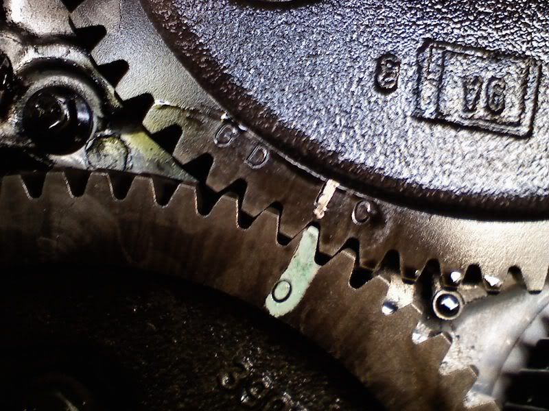

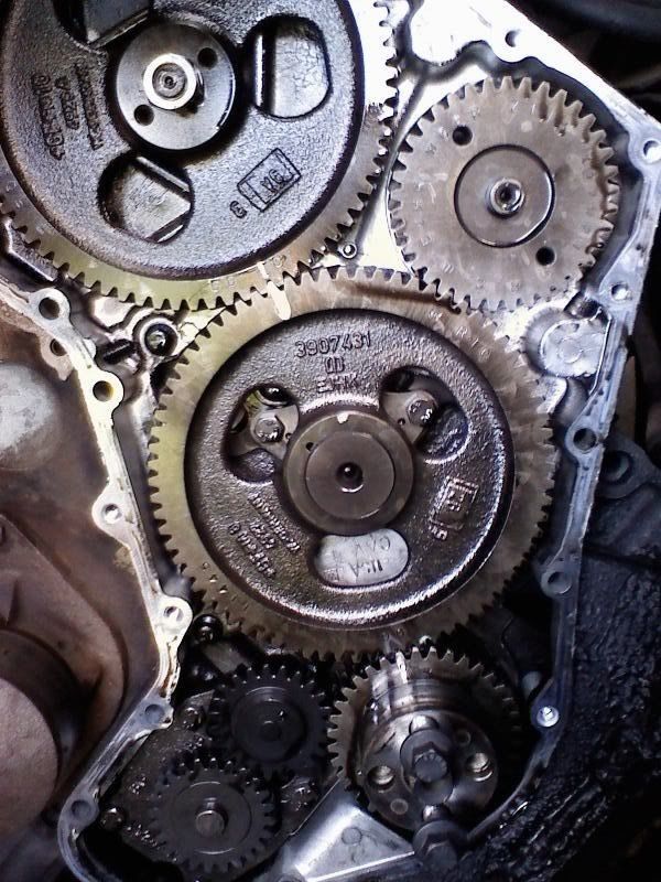

Postby SNOOT » Mon May 25, 2009 8:10 am
1993 W350
SNOOT
Posts: 609
Location: Seattle, WA.
Postby seeker1056 » Mon May 25, 2009 9:34 am
nice pix snoot
cant tell from the white what letter that is though
could you post the letter and thanx for your efforts

Postby PToombs » Mon May 25, 2009 4:44 pm
That's the "E". It's all straight lines. Notice the keyway is at 5:00 also.
