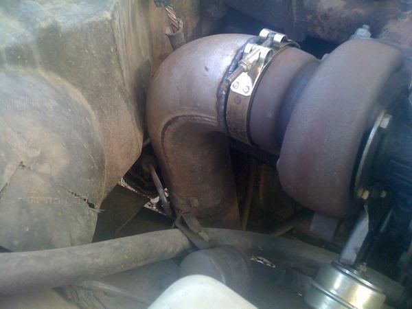

Postby CaptainChrysler » Sat Nov 14, 2009 6:43 pm
I have 2nd gen exhaust on my '93. I used a slight bend and a 90* to adapt to the HX40 when I put it on. It was a normal 2nd gen DP with the cast elbow before.

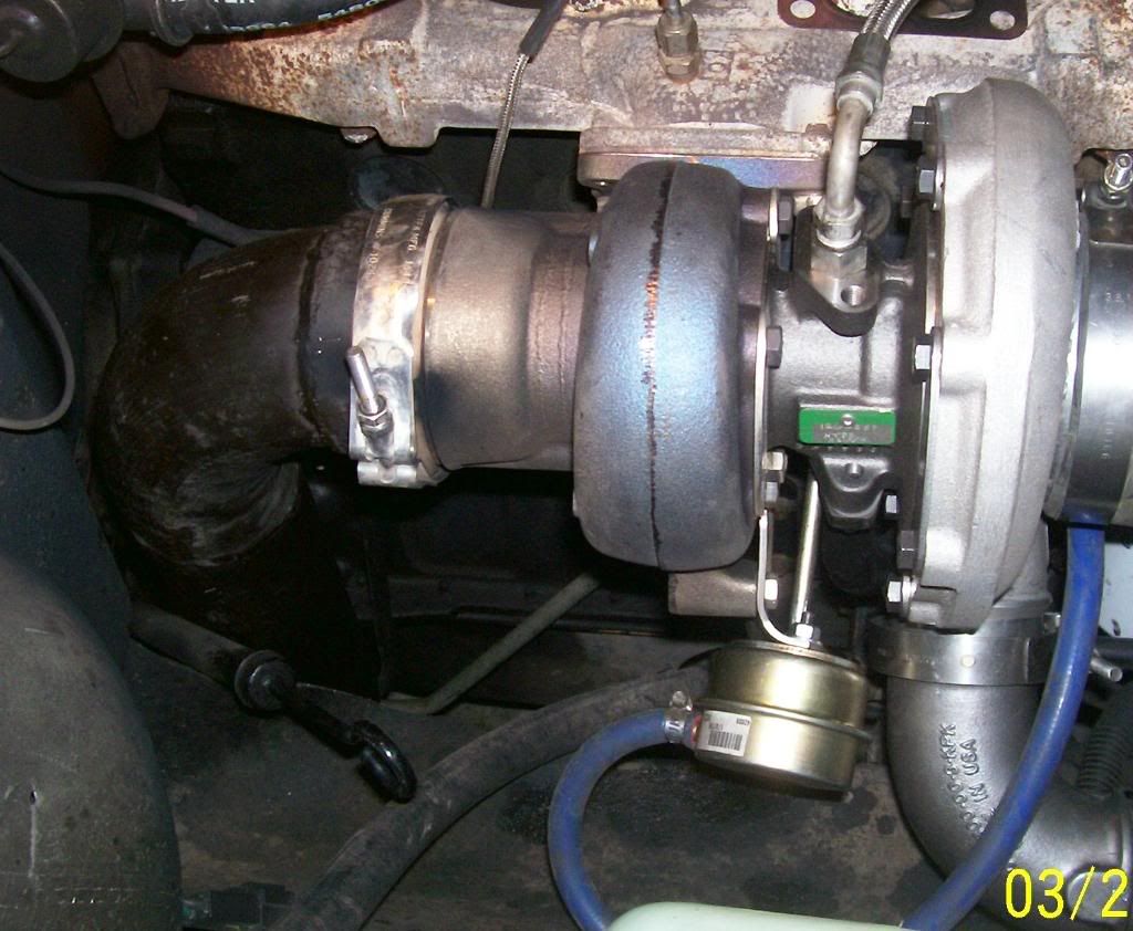

Postby 92 D/UNIT » Sun Nov 15, 2009 9:58 pm
a bit dark but it was made with a 90 elbow and a short piece of 4" exh with nother 90. make sure you get the right v-band clamp not just any 3.75-4" will do.

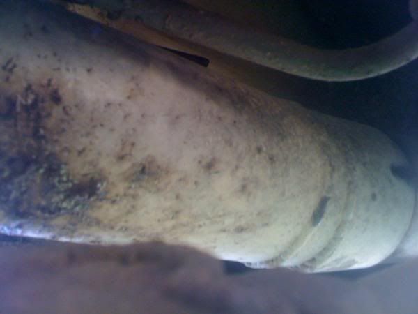

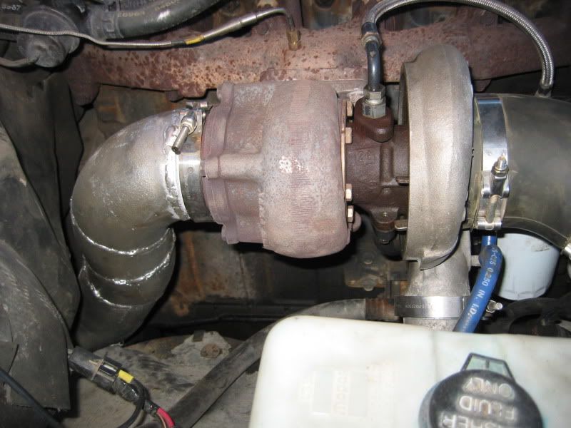

Postby Tacoclaw » Tue Nov 17, 2009 10:10 am
Here's mine, although, 92's looks about the same.
We had to cut the first 90* right up against where it begins it's bend to get it to clear the firewall.
And the on bottom, the only mod I had to do was cut a relief almost all the way through it and close and reweld it.
We only used 2 90*s though, as far as I remember...
