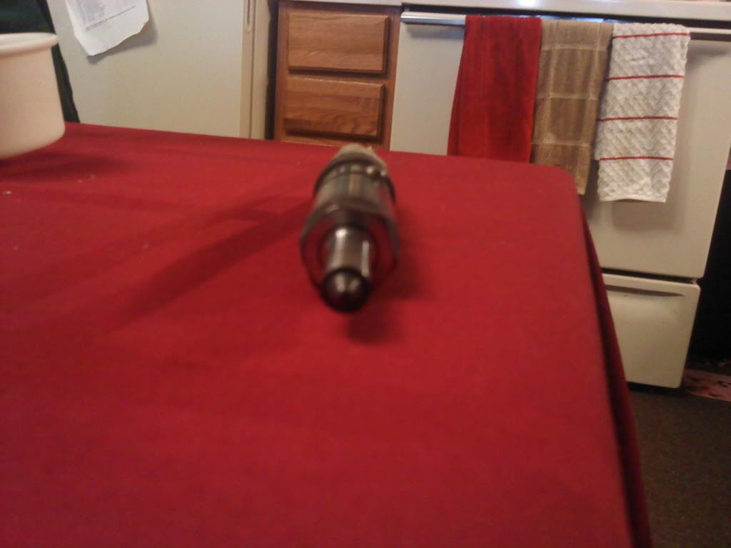

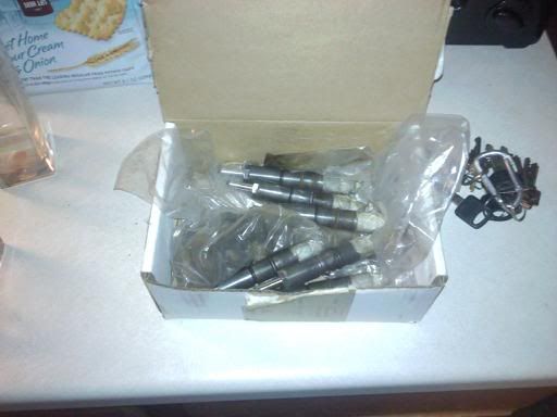

Postby oldestof11 » Wed Oct 27, 2010 1:58 pm
:D:D:D:D:D:D
Injector size is 4x.013.
No typo.
Someone wanna guess where these puppies came from? They fit the 7mm head now.

Postby oldestof11 » Wed Oct 27, 2010 2:29 pm
Used @ $115 and $25 from the machine shop.
But you need to tell me what Engine (be specific) it came from. :lol:

Postby oldestof11 » Wed Oct 27, 2010 8:34 pm
You guys are no fun....
Non-IC injectors turned down.
Got it all in and buttoned up...
HOLY COW!!!
You Non-IC guys do not realize how good you have it! From a standstill, I can now burn out through 1st, part way into 2nd and chirp 3rd! With a slush-box mind you.
I have a small problem. Injector number 5 hold down got wet before I changed injectors and now it spurts a fine mist in the 10mins it took me to get home, it soaked the engine in fuel... I didn't notice it at idle in the dark but I did after I got home! Anyone have suggestions?

Postby oldestof11 » Fri Oct 29, 2010 1:48 pm
REused the 9mm washers. To keep them on while putting the injectors in, applied a SMALL dab of petro jelly. The washers that the 7mm had were 2x as thick. I remember with PODs you want the thinnest ones.
And to answer the misting, bubbling problem, it was the nut wasn't tight enough. :shock:

curious on how they "turn them down" not to injector savvy, care to explain?
Re: Injector Porn
Postby oldestof11 » Wed Nov 03, 2010 6:10 pm
They put the body into chuck and check it for being true center via micrometer. Then they take them to a surface grinding machine and mount it.
They get the tip lined up under the grinding wheel. Using 1 hand to spin the chuck, the other then lower the wheel on it and when it just barely touches, they start grinding away .010 of material at a time. Once at the .010 mark, the hand that was lowering the wheel then turns the wheel to push it into the wheel. Its like a lathe.
