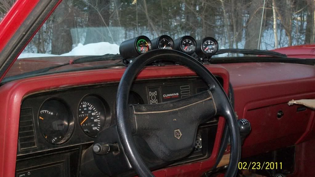

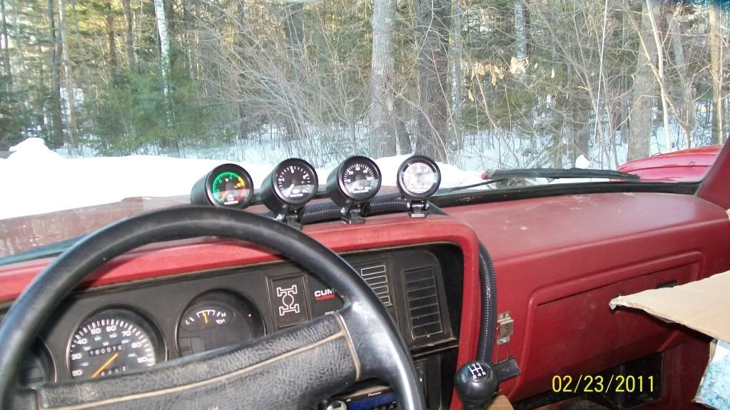

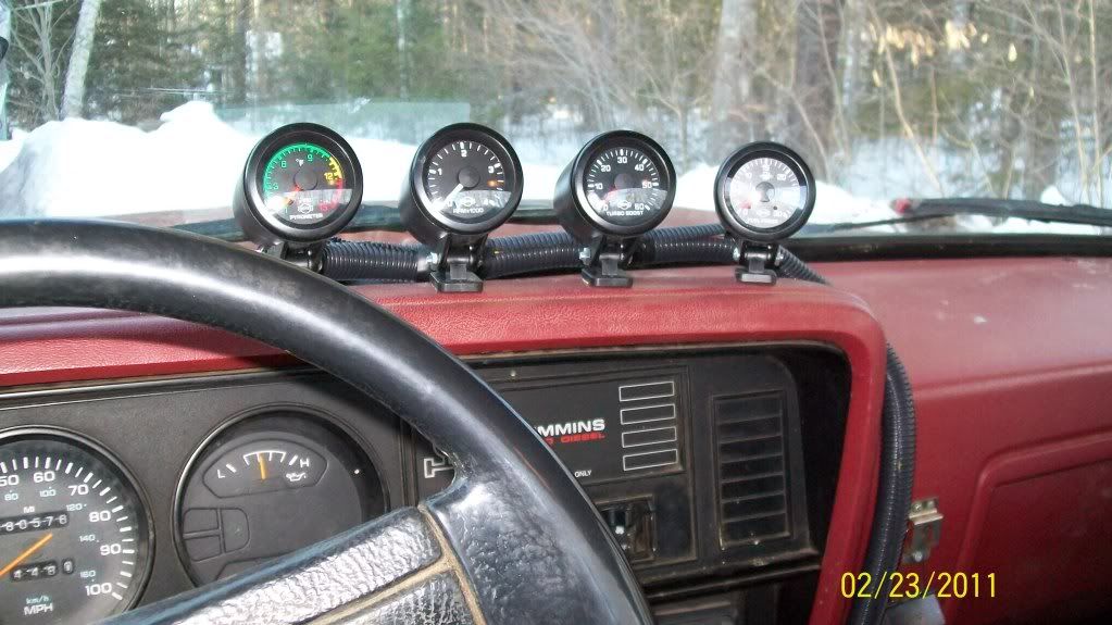

I have a couple more to get for the 89, but atleast all 3 have some of the needed gauges. This is in the 92 ( stockish ) truck.
So far wide open with load is 15 psi and 1100 degrees. This truck sure is a turd. 21mc housing and all. :D

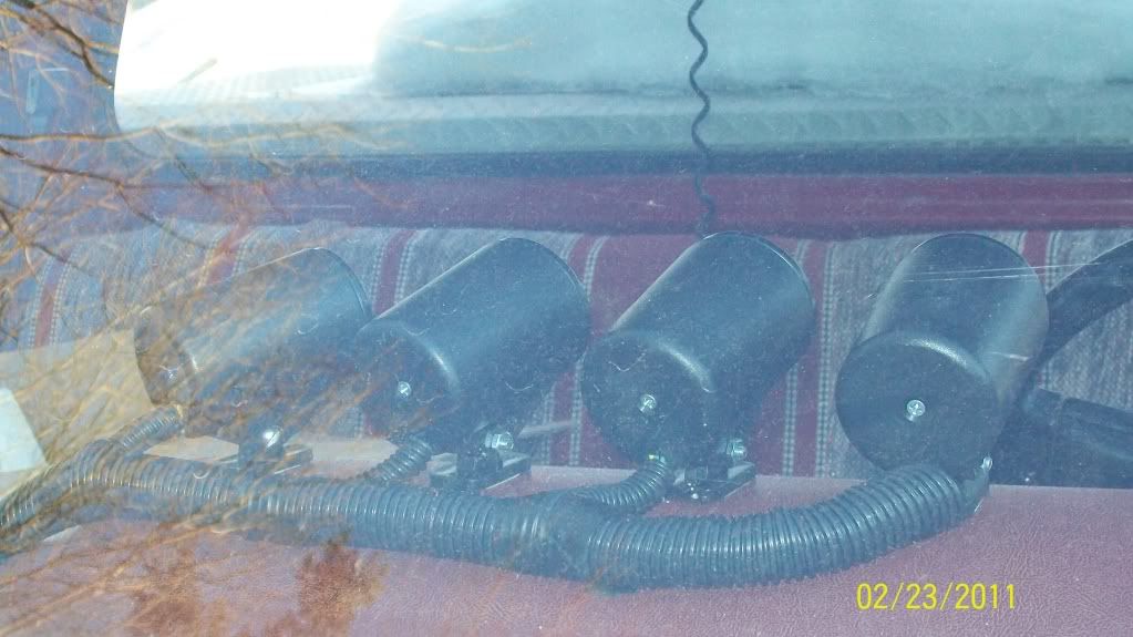

Nice low profile wiring job. Matches that red interior perfect! :lol:
Re: Last truck now has gauges
Postby Richie O » Wed Feb 23, 2011 6:53 pm
I just won't drill a dashboard. I know the wires look crappy, but I like it better then a bunch of holes.

It looks good, Rich knows I'm busting his chops. ;) Here's another option for running wires, route them straight toward the defroster vent and slide them down the edge between the dash top and vent. IIRC, there's enough room to slide them thru there.

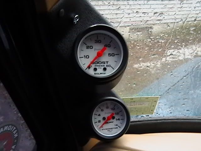

did you mount the gauges in your other trucks the same way?? ( top side of dash) or ??? i havent put gauges in mine yet, i have them in the garage, just need a pyro lead. i took them outta my 97 6.5, i had a pillar pod on that one, but i just dont think my pillar pod will work :lol: :roll:
just kinda hunting for ideas, i like the loom to hide the wiring
1990 W250 dodge ex cab, LB, work in progress. truck was originally reg cab/lb, ex cab is an add on.fuel pin turned, 30psi, bhaf, straight piped 3", new rear springs with shackle flip, 4" lift front, crossover steering, waiting on piston lp, c/c s/b conversion, turbo upgrade and intercooler install
manyholes
Posts: 83
Joined: Sat Oct 16, 2010 8:30 pm
Postby Richie O » Sat Feb 26, 2011 2:55 pm
manyholes wrote:did you mount the gauges in your other trucks the same way?? ( top side of dash) or ??? i havent put gauges in mine yet, i have them in the garage, just need a pyro lead. i took them outta my 97 6.5, i had a pillar pod on that one, but i just dont think my pillar pod will work :lol: :roll:
My 89,
My 93 home made nightmare, :D
