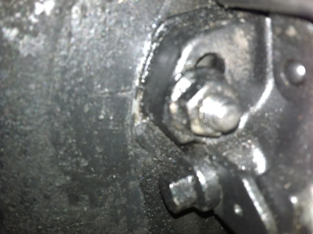

Timing marks
I had someone else do the timing on my truck a year or so ago. I always thought it was to the head becaise my afc housing(when i had one) was very close to the head. I am getting prepared to put the timing back to stock just in case what i have now and the spacer will be to much. The mark on my pump is not there? U can see the mark on the timing case clear. What do you guys think my timing is at? Think i can run this and the spacer? Wheres the beat place to get a wrench to do the job? Etc etc. please tell me what you think and know anout all this...

Postby Remps » Mon Mar 26, 2012 9:12 pm
With 7x15 injectors I'd personally try it without retarding the timing.
