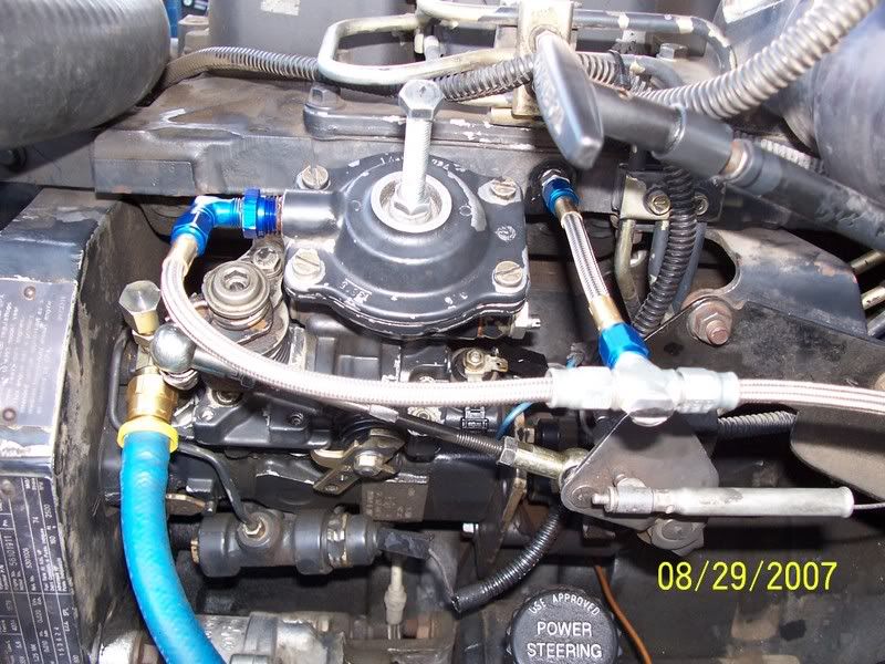

Why is there a bolt sticking out of your AFC?

Postby SChandler » Thu Jan 24, 2008 1:50 pm
Begle1 wrote:Why is there a bolt sticking out of your AFC?
Looks to me like a replacement smoke screw - say goodbye to Torx head bits!

Postby Begle1 » Thu Jan 24, 2008 1:54 pm
Don doesn't really strike me as the kind of guy to worry about the AFC enough to replace something, though...

Postby SChandler » Thu Jan 24, 2008 3:20 pm
Yeah, I know, but that's what it looks like to me.

Postby DTanklage » Thu Jan 24, 2008 5:03 pm
it is just what it looks like it is - a longer bolt
lol
that was back when i was playin around with the afc
if i wanted full fuel off idle i could just screw the bolt in until the fuel cone was all the way down
tested it like that, then removed the lever entirely
removing it makes a big difference
and that is going from a fully ground cone to no afc
big difference
i love it
