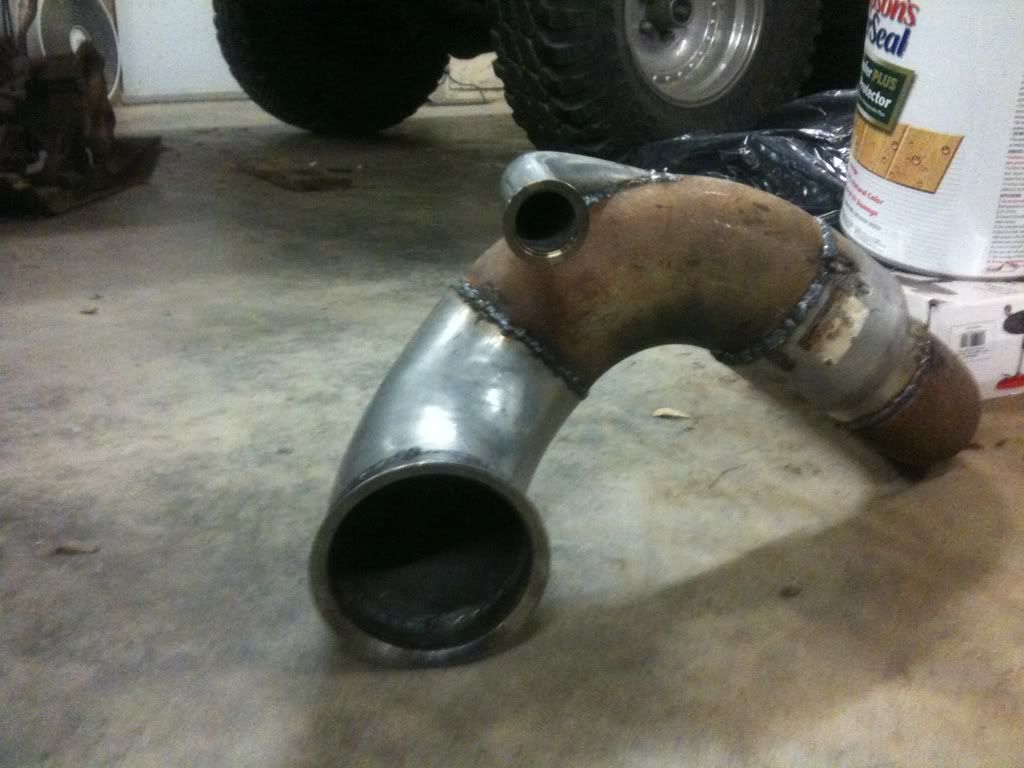

Postby Tacoclaw » Sat Oct 01, 2011 7:02 pm
Moar!!!
No thumbnails since I'm on my phone.
Got the dump and DP welded up.
And yes, Andrew, I drove it around with the twins. The S300 is silent while cruising now, but that may be due to it not having a hood. I did get peer-pressure'd into a burnout while leaving the garage.
A one-wheel-peel, but turbos were heard spooling. :D
