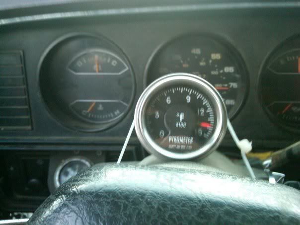

raced a Durtymax on the highway today, pegged my pyro for a good 10 seconds :shock: ....took a picture afterwards, going like 90(speedo is way off)..3/4 throttle, racing up towards the 1500 degree mark like it was going to hit and bend the needle.
...but I beat the d-max 8) , at the light after the short highway run he said his pyro-limiter cut fuel at 117 :D :grin:
