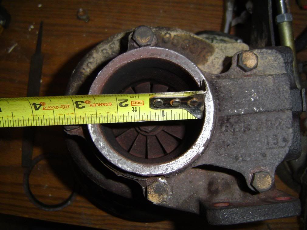

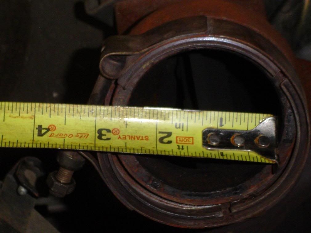

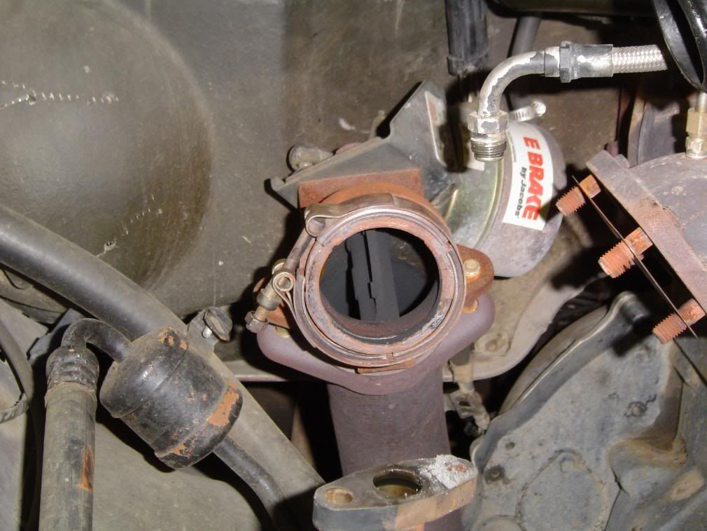

Postby flashgordon » Sun Dec 02, 2007 10:05 pm
Been working on my intercooler project and desided to take a couple of pic's while i had the turbo off.
http://i125.photobucket.com/albums/p58/ ... C01893.jpg
http://i125.photobucket.com/albums/p58/ ... C01894.jpg
I thought our outlets were 3" :sad:
http://i125.photobucket.com/albums/p58/ ... C01895.jpg

Postby DTanklage » Mon Dec 03, 2007 9:08 am
that is what i was saying in my tdr thread - no need to step right up to 4" if you are running a stock turbo
for drag racing we use stepped ex
for optimum flow the i.d. of the tubing would increase at 4° increments
but using those numbers it would be 2.5" at the turbo and over 6" behind the tire
one thing is for certain - the hot ex gases are expanding so you dont want to neck it down anywheres down stream

Postby DTanklage » Mon Dec 03, 2007 9:47 am
ps - i am not running a stock turbo
that housing is 4" i.d. at the outlet
