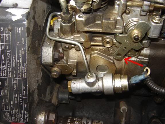

Postby SChandler » Tue Mar 03, 2009 4:43 pm
This is a picture of the injection pump on my truck. You can see the data plate to the left of the injection pump on the end of the timing case. That is the plate with the information on it that will help you determine what the specs are for the engine (HP rating, serial #, CPL - used by Cummins to look up engine specific parts, timing, etc.).
Edit: Ignore the red arrow. I used this pic to show where the manual shutdown lever is on the pump in another thread.

Postby finn188 » Tue Mar 03, 2009 4:56 pm
SChandler wrote:This is a picture of the injection pump on my truck. You can see the data plate to the left of the injection pump on the end of the timing case. That is the plate with the information on it that will help you determine what the specs are for the engine (HP rating, serial #, CPL - used by Cummins to look up engine specific parts, timing, etc.).
Thanks I will find it no problem now im sure.
