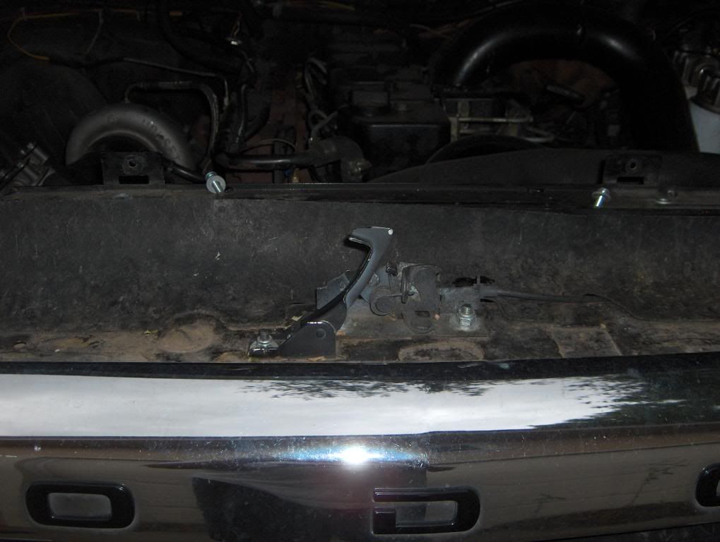

Postby apwatson50 » Mon Aug 03, 2009 3:30 pm
DLittle wrote:Image
That looks like how I installed mine. I took that whole angle brace out of there. Then put about a 10x3x1/4" plate in there to give everything extra support. I was also able to reinstall the vertical support brace that is out in front of everything.
Now for the safety latch. I grabbed one off a jeep cherokee, turned it upside down and it latches onto the metal rod on the hood that the regular latch grabs.
Aaron

Postby PToombs » Mon Aug 03, 2009 5:54 pm
What if the bar breaks? That's why they latch in 2 different spots. ;)
I'd like to see a pic of how you did it. Inquiring minds want to know! :lol:

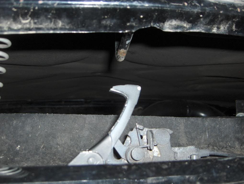

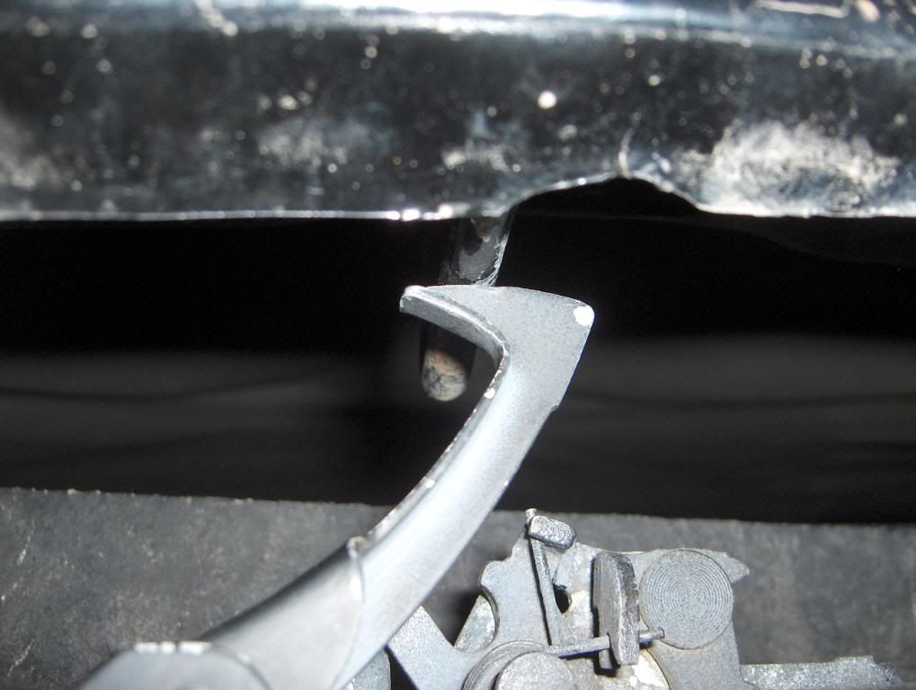

Postby apwatson50 » Tue Aug 18, 2009 7:02 am
OK for your viewing pleasure, my Jeep cherokee hood latch. Hope the pictures make sense!

Postby PToombs » Tue Aug 18, 2009 5:55 pm
Oh yeah! Not a bad idea! 8)
