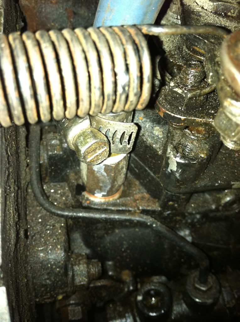

I think so, I've hit 30 psi more than once on a stock non-locktighted seal.
Its definently much easier. Not a fan of all the monkey motion of a regulator sitting on my fender well.
I dont for see any akkidents

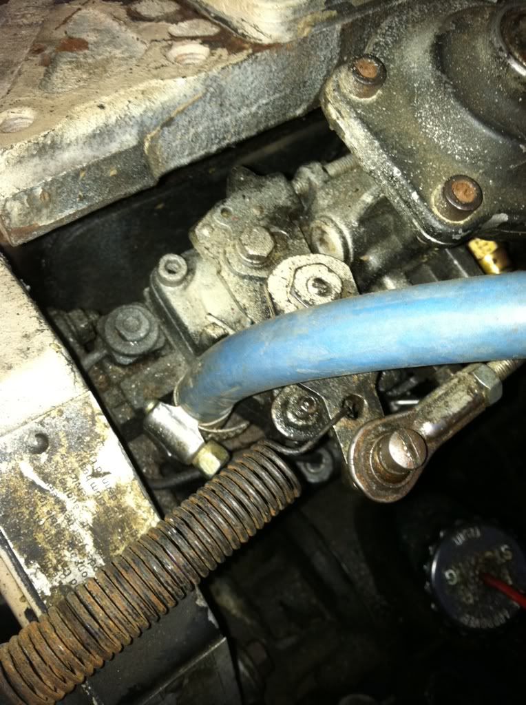

Postby ahale2772 » Tue Dec 20, 2011 5:12 am
LOL its what my dad usually says when I rig up some system like the one thats on my truck, too much going on.
If I rigged it all with hardlines and hung it under the intake log on the head, that would work, but right now its all done with parker pushloc and its kind of a mess.
Pete, dont think the seal will like 30psi at idle?
Re: Next stage- Twins (last page)
Postby PToombs » Tue Dec 20, 2011 6:31 pm
Maybe for a little while. I wouldn't trust it not to pop out. A rubberized seal Loc-Tited in, and expansion and contraction of the pump thru heat cycles......... :-?
20 psi, no problem, even 25. I think 30 is pushing it. JMO. (remember, 19 with 30 years experience ;) )

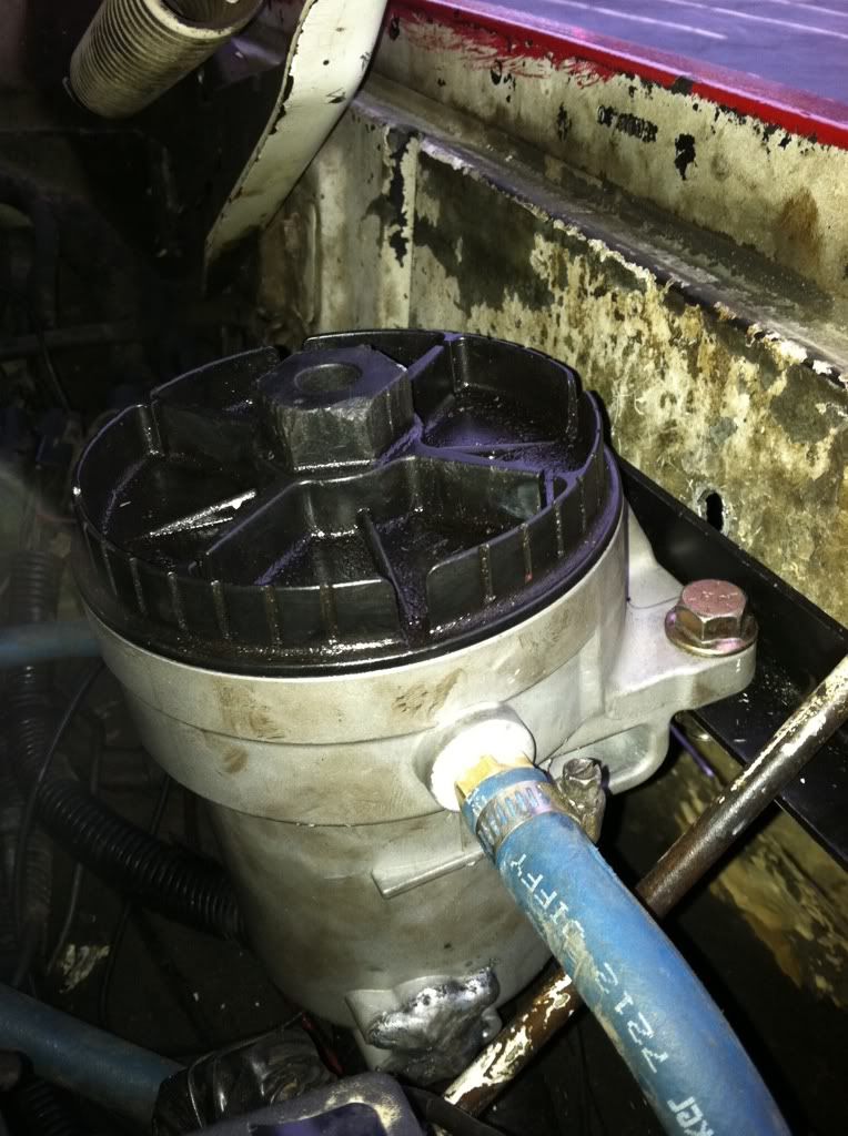

BTW it can be done...
eliminating that stupid feed line that is... I used a straight thread to pipe adaptor fitting, then drilled it out on the lathe till I got the most possible out of it 8)
crappy messy pictures... the old girl is pretty filthy right now
and my new filter housing, works quite well

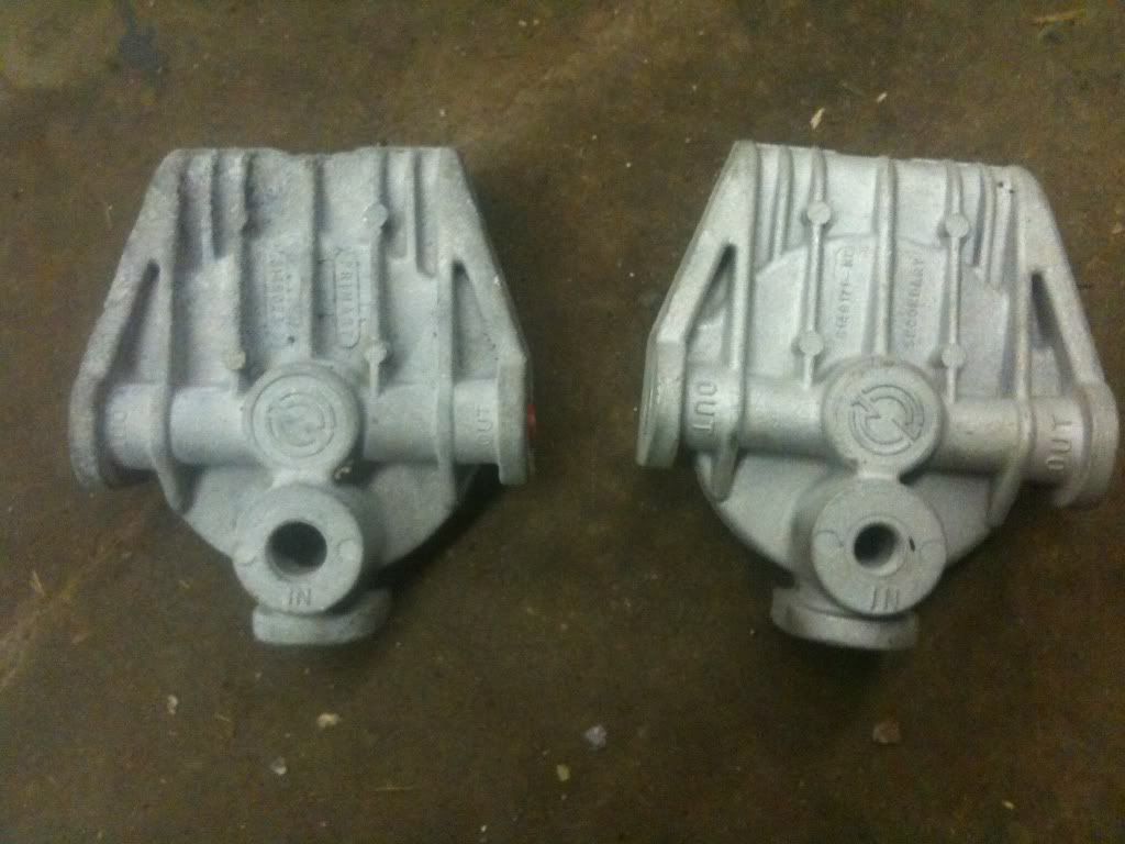

If you ever buy another 1stgen let me know, I'm going to buy some stock in the Push-loc company. :P
Here's the filter heads I'm going to run, nothing special, but they are threaded different for primary and secondary.
