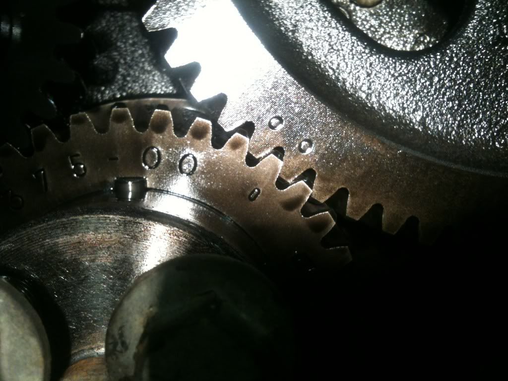

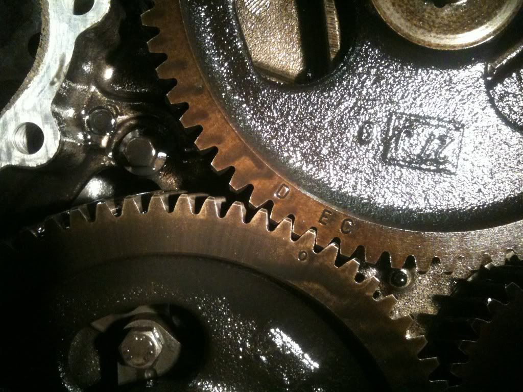

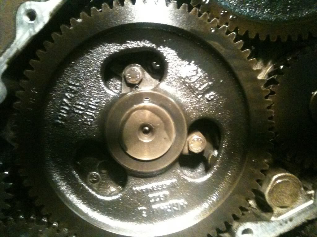

Well, the truck once again proved boring and predictable...
Timing is stock and KDP is snug as a bug.
Cam bolts are at least finger tight, I didn't bother to get a socket since they don't need to come out now anyways.
And these things point at each other like they should too, so I figured it was worth capturing in a photograph. 8)

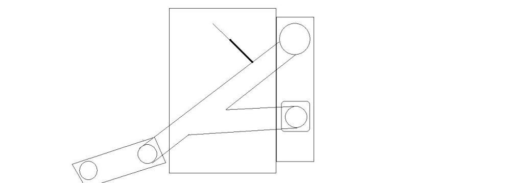

Postby Tacoclaw » Sun Jan 08, 2012 5:51 pm
Behold the fury of Microsoft paint:
The plan is just what you see. Running a 3" (maybe a squished 4") hole at the back of the intake, then Y in another pipe that goes to the factory grid heater at the front. I'm looking for a 3" guillotine to run towards the back inlet, so I can close it when it's really cold and just pull through the grids. My truck is still a little grouchy when it's real cold and it's not plugged is, so the grids are needed if ether isn't available.
I am debating on whether to lean the rear inlet so it points towards the back of the head or if just it's location will be enough.
Postby ahale2772 » Mon Jan 09, 2012 8:38 am
shooting the inlet twards the #6 runner would not hurt.
