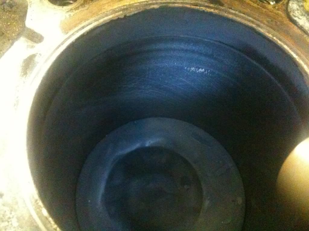

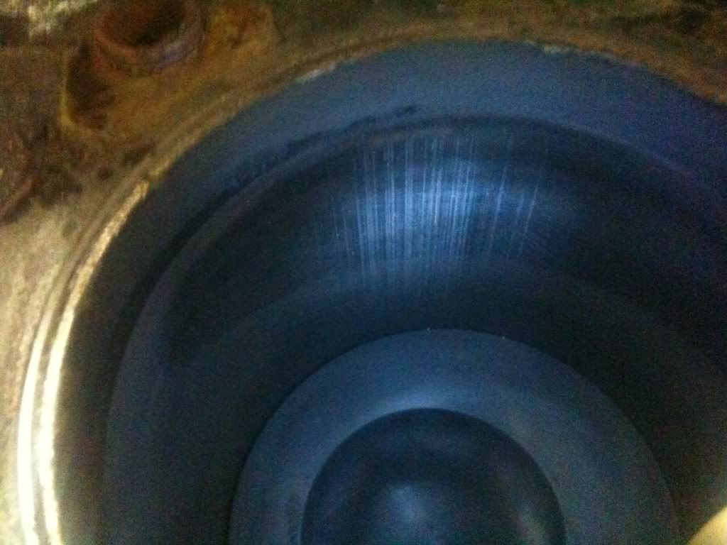

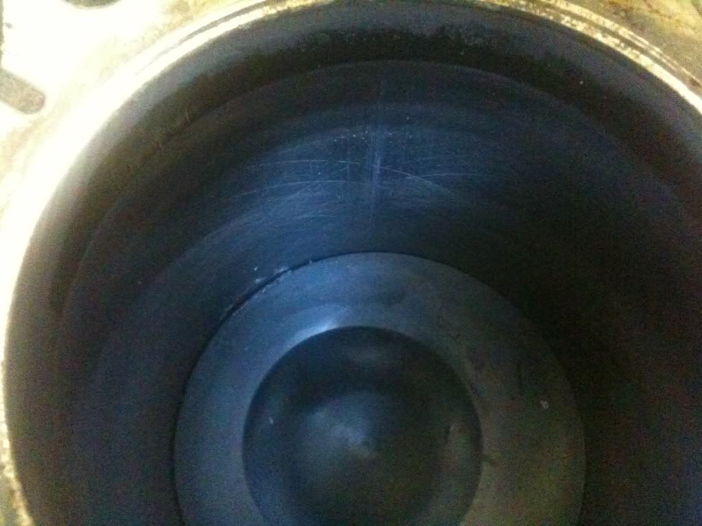

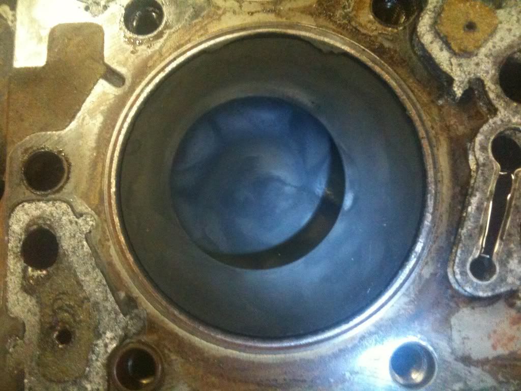

Got the head off and hanging tonight. I'm debating on just getting it hot tanked and letting them install the springs while I get the block cleaned up. I can't wait to hear about all the cracks it's got in it. :lol:
Anyways, here's the goods(bads)
2
3
4
5
They've all got a bit of scuff to them, but #5 is pretty gnarly. The crosshatch is still there on all of them, and the worst scuffs on #5 can barely be felt with a fingernail, but it sucks to see them.
Spray pattern on #1, 5x14 of unknown spray angle
Overall view of the ugly
I blame the scuffing on how I've treated the truck. It sat in a barn for a couple years after I bought it, then one day, in the middle of winter, I pulled it out and started driving it. It sits for a few months, then gets driven for a few, then sits for a few. Hopefully I can run it a little more often once I get this stuff done. I think I'll be happy engine-wise after this.

I think if it was me I'd pull it the rest of the way apart. Go ahead and replace the bearings and rings and atleast hone the cylinders.
Postby 1990 » Wed Jan 11, 2012 7:01 pm
dazedandconfused wrote:I think if it was me I'd pull it the rest of the way apart. Go ahead and replace the bearings and rings and atleast hone the cylinders.
I agree.

Ive been told many a time that anything that can be felt with a fingernail (on a cyl wall) is grounds for a re-bore.
I would run it for now, seeing that you have lots of goodies coming.... but I would also buy a spare and rebuild it IMO

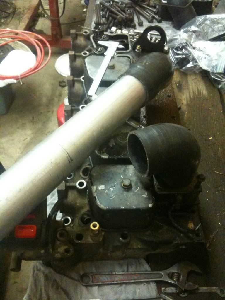

Messed around some tonight, fabbing around on the new intake:
It's not quite the angle I expected them to intersect at, I apparently thought the intake hole was a lot longer than it is. It'll be shuffled around as it comes back together and injection lines get in and out of the way, but this is what I'm looking to do.

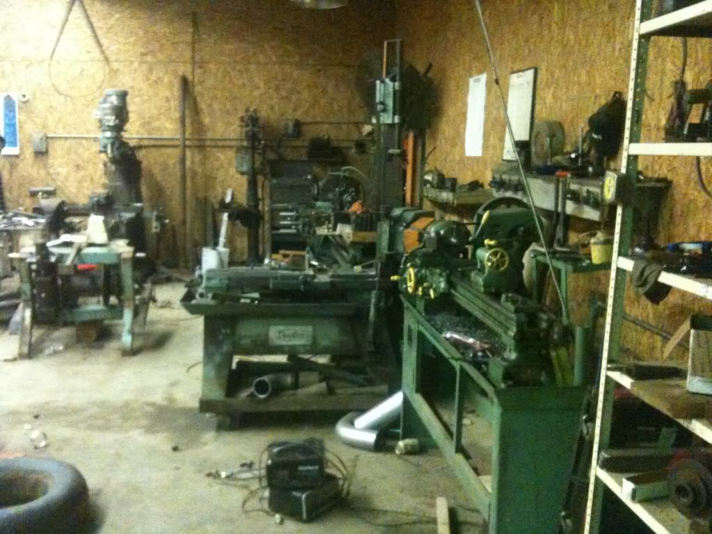

Here's the old man and I's "machine shop". They're all old, but I couldn't imagine trying to make something without them anymore. Especially the mill and bandsaw. I'm pretty sure a man could make anything in the world with a mill, bandsaw, and welder.
