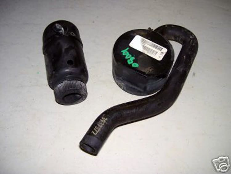

I have some pics of the super breather valve covers.
You can see the oil drain tube sticking below the bottom lip.
Here is a top view, showing where the oil drops out, and the drain.
And the breather, sorry it's fuzzy, I was a little too close! ;)
Postby BC847 » Sun Mar 30, 2008 4:52 pm
Yup. Wye two of the industrial vents to a 3/4" line that runs to the rear/inside of the driver's front tire.
Then take one of the 24 valve crankcase vents and wye it into the OEM lifter valley cover vent, and with a second 3/4" line, run it on out with the first in parallel.
The total of four vents pretty-much eliminates any crankcase pressure issues that I'm aware of. Why four? It allows the escaping gas velocities to be low enough that the oil mist collected by the impingement device(s) is less likely to be blown from them and on out of the pipe(s).
Works quite well IMO. I'm even considering routing the vented gases back into the BHAF. :)

Postby bgilbert » Sun Mar 30, 2008 6:56 pm
Dang those are sweet!!! Can't wait til mine get here 8) . I have the 24 valve style breather on my 89, soon to be twin turbo'd. I bought one of these breathers for each truck hehe.
