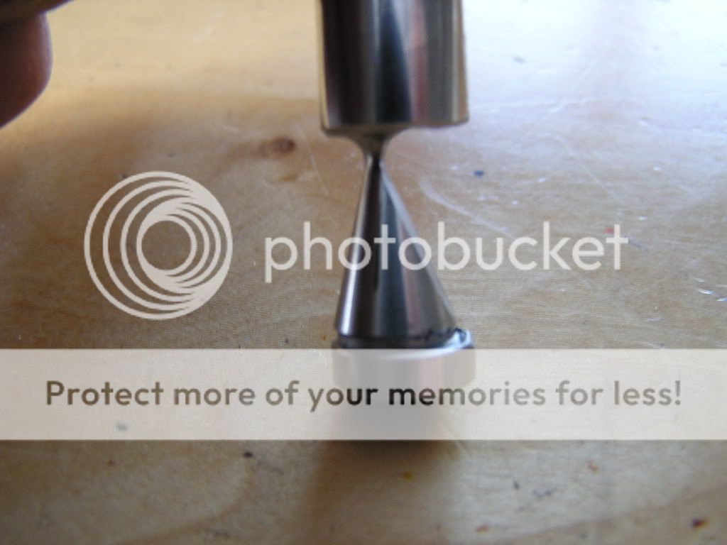

Postby IrishChamp » Wed Mar 09, 2011 1:36 pm
Here are a couple pictures, 1st one is what I did yesterday, then I worked it again today.

Postby IrishChamp » Wed Mar 09, 2011 10:04 pm
And a little more work, I noticed that the new wear track was going past the low point back up the slope towards the body so I extended the low point to the body of the cone rather than having it blend into the natural ramp into the body of the cone. I think I'm done!

Postby IrishChamp » Fri Mar 11, 2011 12:04 am
I picked up 1 or two lbs of boost with the last grind and a little starwheel tweak.
