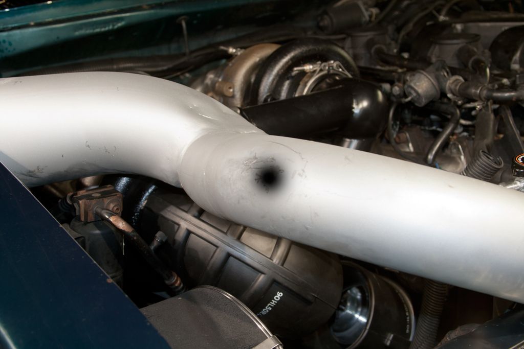

Got back in time to mess with the down-pipe. I'm embarrassed to say that I flat-spotted that one offending curve, right there at the heater motor. I'll remove a bit of the HVAC box's noise-blanket and replace it with a sheet-metal heat-shield. With that, I can better locate the mass overall.

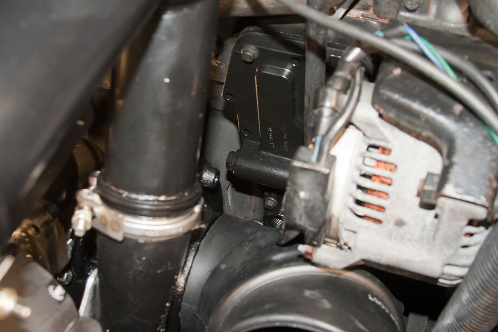

Fast forward to now, I've got the turbo-mass where I want it. With that, I'm able to better visualize the needed bracket. I ended-up just making a one-piece bracket . . . .
Attach the bracket to the lower primary compressor-housing and, swinging the turbo-mass down and into position, has the bracket come to rest as planned on the engine oil-cooler cover-plate and fastens with three bolts.
(Dead-center of the pic is the engine oil-pressure-regulator assembly. At 11:00 is the block-heater), . . . .
Looking from under the truck, under the main down-pipe forward, you can see two of the three bolts attaching the bracket to the compressor-housing.
(Again, at the top-left is the block-heater. To the bottom-left is the passenger's engine mount. That pipe to the bottom-right is the HVAC compressor's suction line. It's gonna have to move. :?
With that, the turbo-mass is solidly located to the engine. I've well over 1.5" between the bottom of the top primary housings and fender-well, and the bottom primary intake boot fits as it should.
